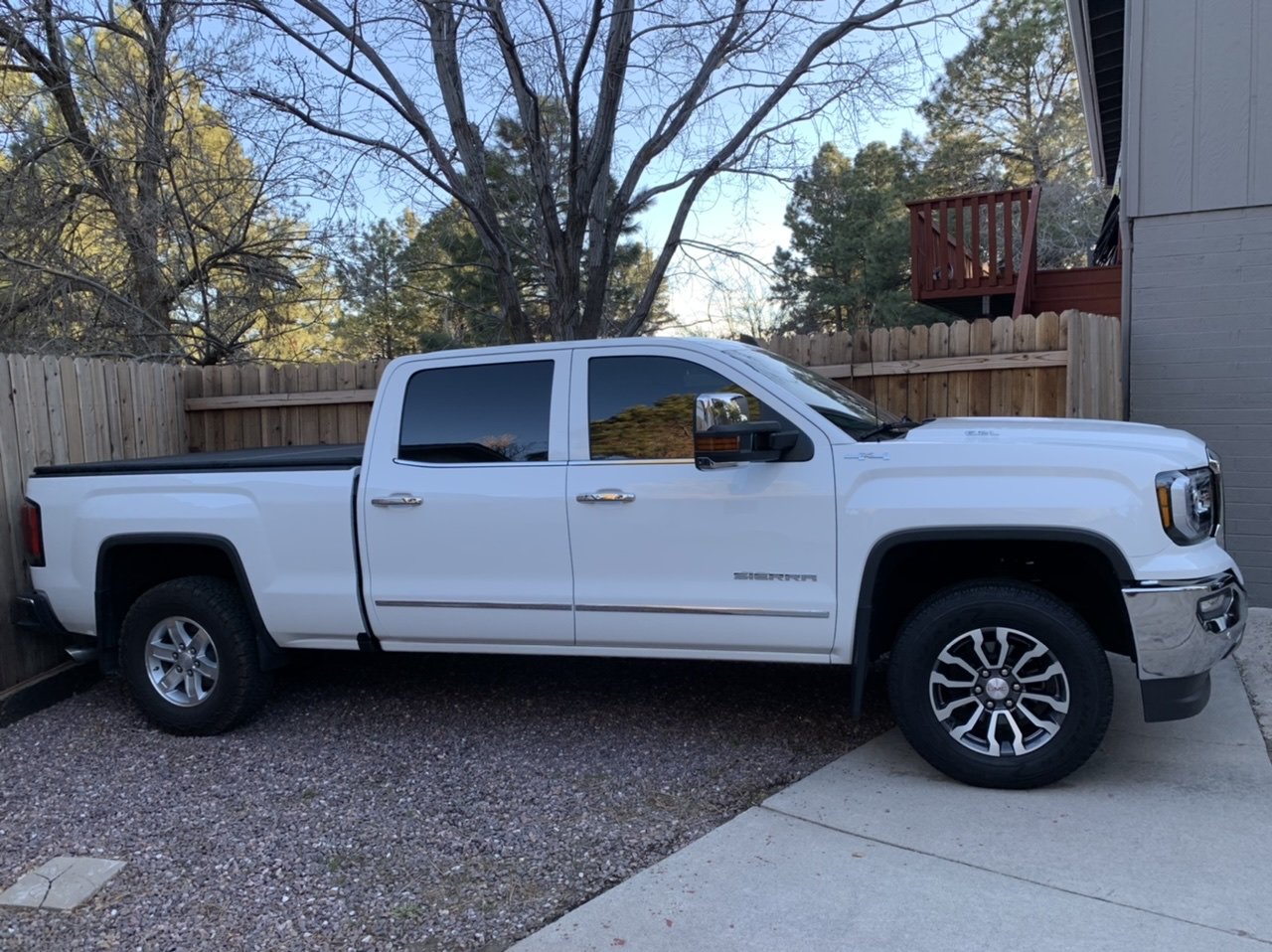

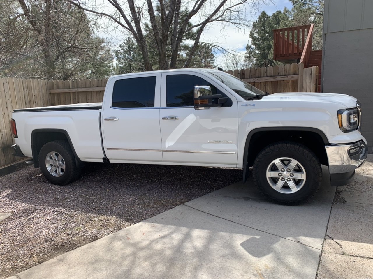

Winter to summer tires. T1XX AT4 wheels on K2XX

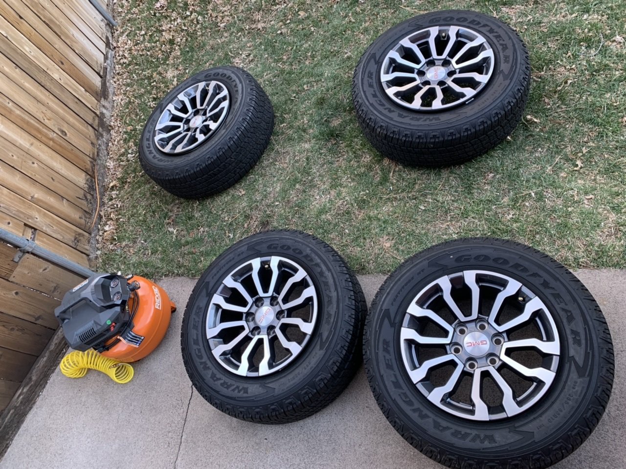

I picked up a set of AT4 wheels and tires. I like the look of them but this set came with the smallish 265/65/18 Goodyear Fortitude HT tires. They’ll be fine for all the summer driving and can save some wear on my 285/70/17 BFG K02.
Noticed an immediate weight difference. Fortitude weighs 56 lbs mounted on 18” wheel. BFG k02 Load Range E weighs 81 lbs on 17” wheel.
