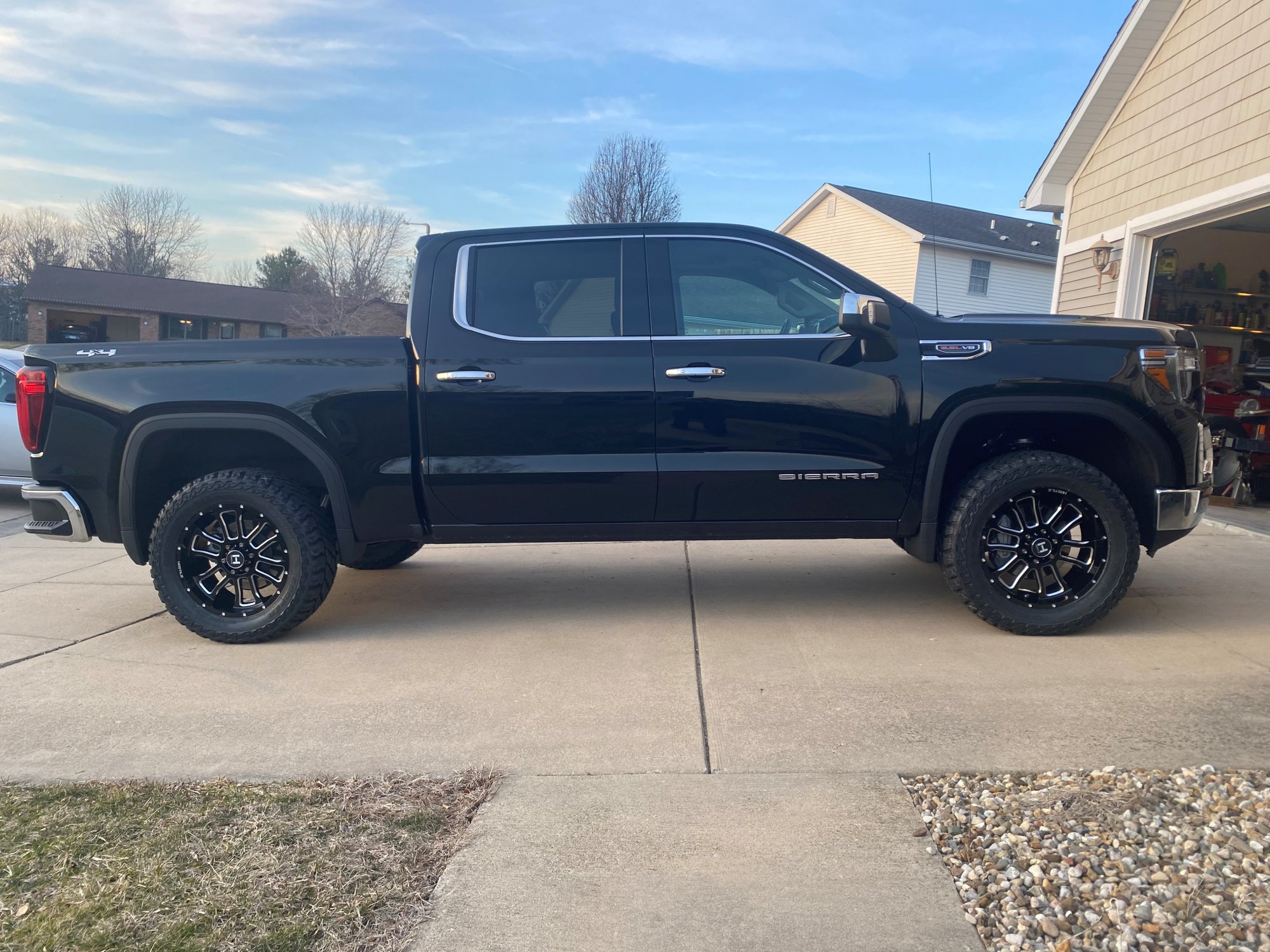

I would venture to guess you “might” be able to get a 35 on a stock(ish) offset wheel with 4” of lift (GM 2” lift + 2” rough country level)... if you’re looking to do any sort of offset 33x11.5 or maybe 33x12.5 and up to around -18 offset could work depending on the tire. I’m running 295/55/20 (BFG K02)on a -12 with 4” of lift and I get a hint of rub in reverse on occasion. There are so many variables that it’s hard to say for sure what is going to work. The GMC T1 has a smaller wheel well than its Chevy brother so you can’t stuff as much tire with the same amount of lift.

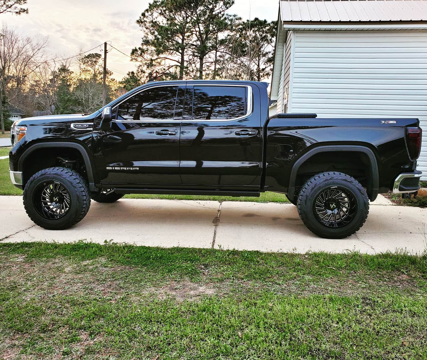

i went to a 3 in lift with a 305 55 20.  the tires  i picked run larger the some others at 33.4 x 12.5  took some trimming  with a +5 offset wheel  but now only rubs full lock in reverse on pass side. if i would have went with the same tire in a nitto ridge grappler i would have possibly not even had to trim since they run just at 33 x 12tr40.thumb.jpg.24ff84fd883a95fdb8bde9784f19c266.jpg
