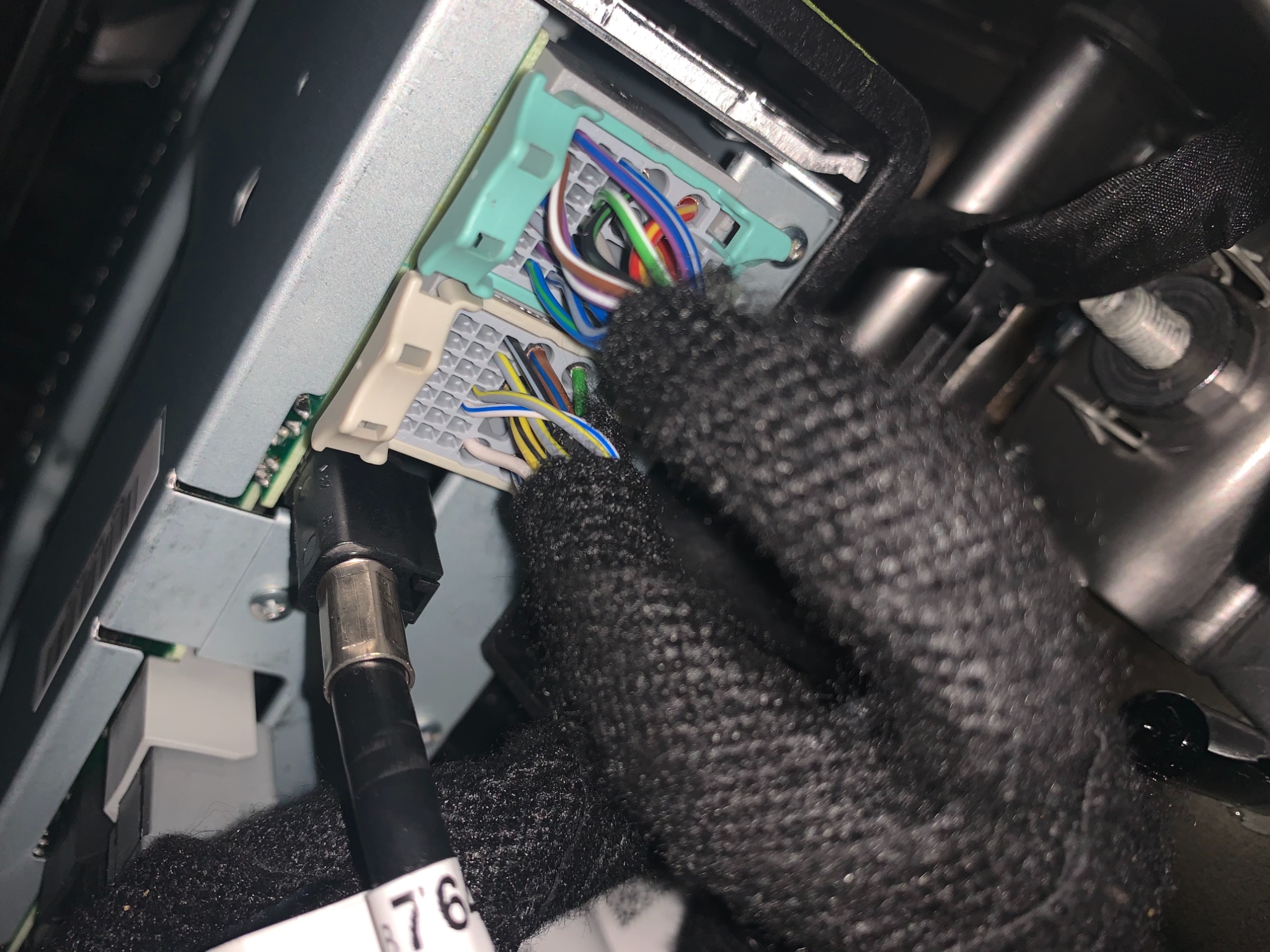

Im looking to get the LLJ harness and asked them where to look for the vehicle connector they ask about (black/gray or aqua/tan).  They said to look and I quote "they will be behind the glove box, above the rear seat".
For anyone that might know these connectors and location that statement confused me a bit.  Is that both places, a mistype from them maybe, or the storage boxes in the rear seats above them?
Passenger side front, below the right side of the glove box. I just stuck my phone camera near the floor board and turned on the forward facing camera and snapped a bunch of pics under the glovebox. After zooming on one of the photos I was able to locate my aqua/tan connectors in the jumble of wires.
Edited by kmoon81
Thanks kmoon81.  Yeah got an email me back clarifying what he had meant to type was glove box above "kick panel" and he had typed rear seat.
So I did find them but appreciate your insight.
