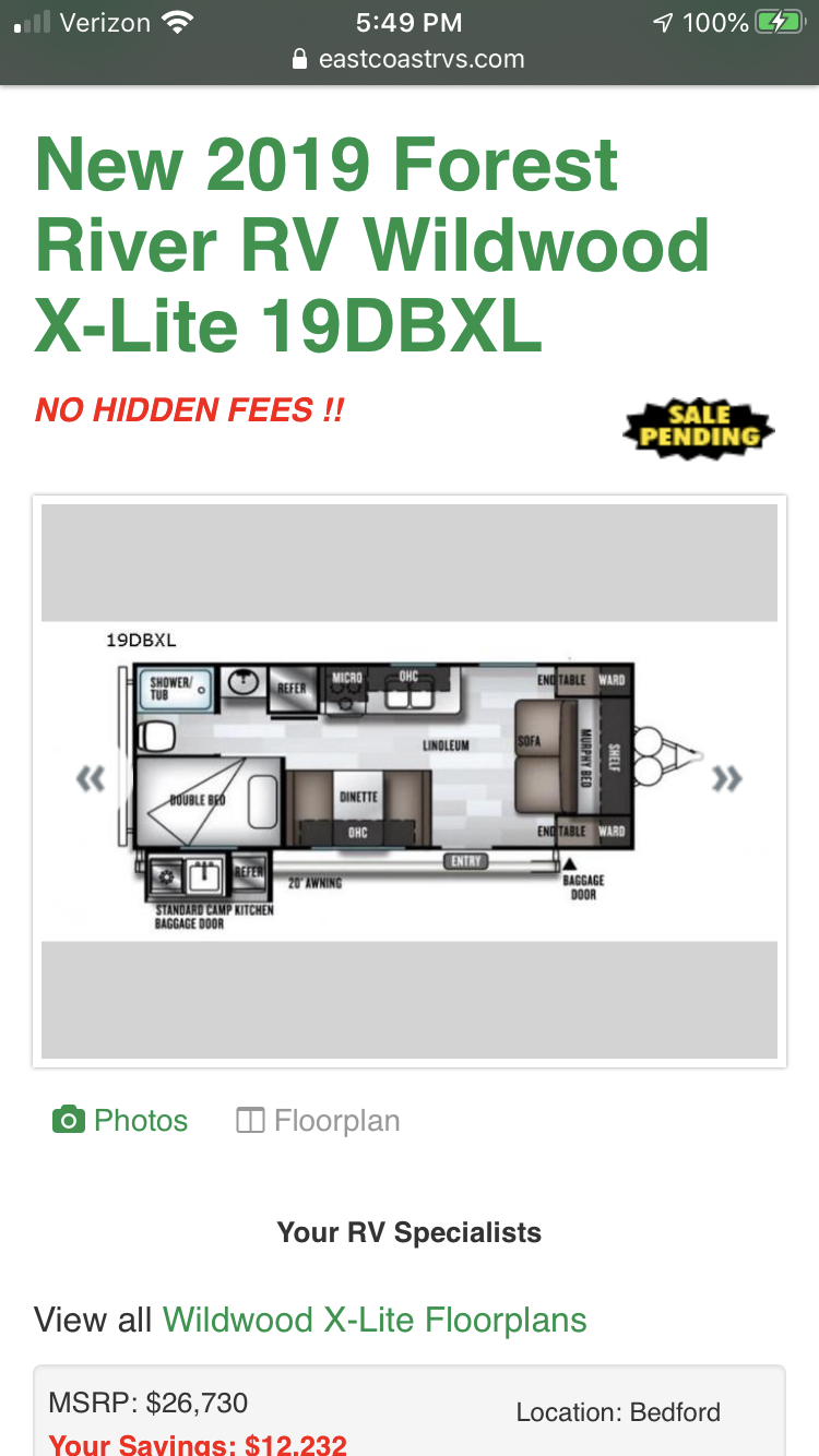

We just placed a deposit on our first TT as well.  Forest River Wildwood X-lite 19dbxl.  The dry weight is 4300lbs.  Gross Weight is 7500.  These guys saying to base off gross trailer weight are crazy.  Each TT has a different cargo capacity, mine being fairly high.  The one you’re looking at has less than 1500 lbs Of cargo capacity.  There’s no way we will have over 3000 lbs in our trailer.  I’m guessing we will be around 5,500 loaded to camp.  Any way you slice it payload is going to be your limiting factor.  We are going to have to pack strategically to stay under our  1500lbs truck payload.

That unit is almost exactly the same as the one we would be getting if not for Corona.  Ours has the bunks and bathroom flip flopped but similar weight and length.  I’ll have about the same cargo as you and fiberglass cap as well.  Good to know the truck can handle it.  I hope I can still get mine after all this nonsense goes away.
