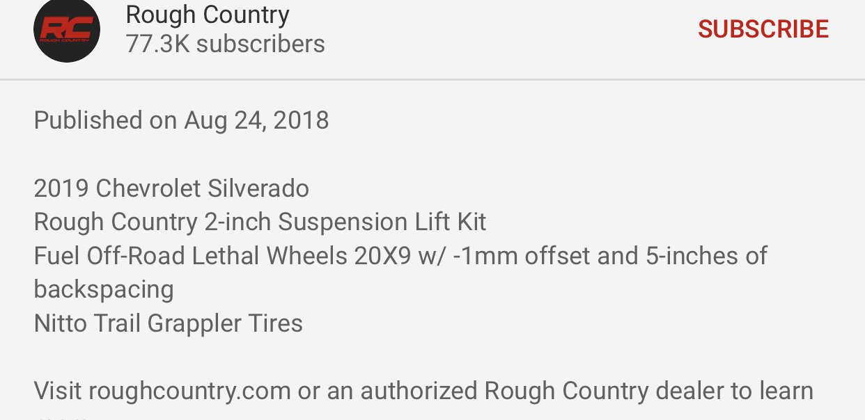

I bought my truck new in November and did this exact setup I saw on rough country’s facebook page. (In pictures). The problem is it drives Soooo bad. Hud shakes/ it’s all over the place in the wind. Tires are so loud. It drove 100% better before. I’m town between these options:

Nitto does make two other tires that are not mud tires, so you could try either of those. The Terra Grappler is going to way more tame compared to a mud tire. The Ridge Grappler is more aggressive but still not a mud tire.

Like others have said, trail grapplers are a mud tire and I can tell you from experience they ride like crap. Being a 20” wheel with minimal sidewall likely only makes it worse. Swap the tires for an all terrain and you’ll be much happier. Do not go to a 22” wheel.
