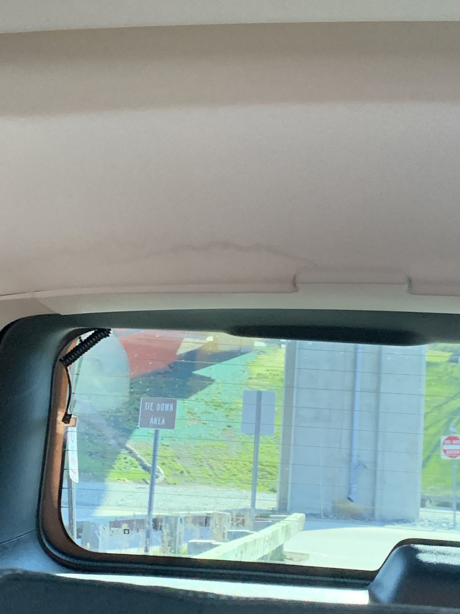

Water stain on headliner at rear hatch
Good morning.   I've seen all the posts about the leaking sharkfin, however I doubt that is the cause of this; this is occurring at the opposite corner of the headliner.
I noticed last week a good size stain on the headliner at the back/passenger corner.
2019 Tahoe w/ 15k miles, no mods, no crashes.  I haven't been able to find anything in the search here or the google machine.  Has anyone seen this??

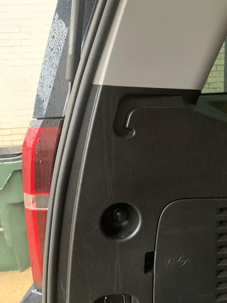

After overnight rain, I was able to track down the leak.

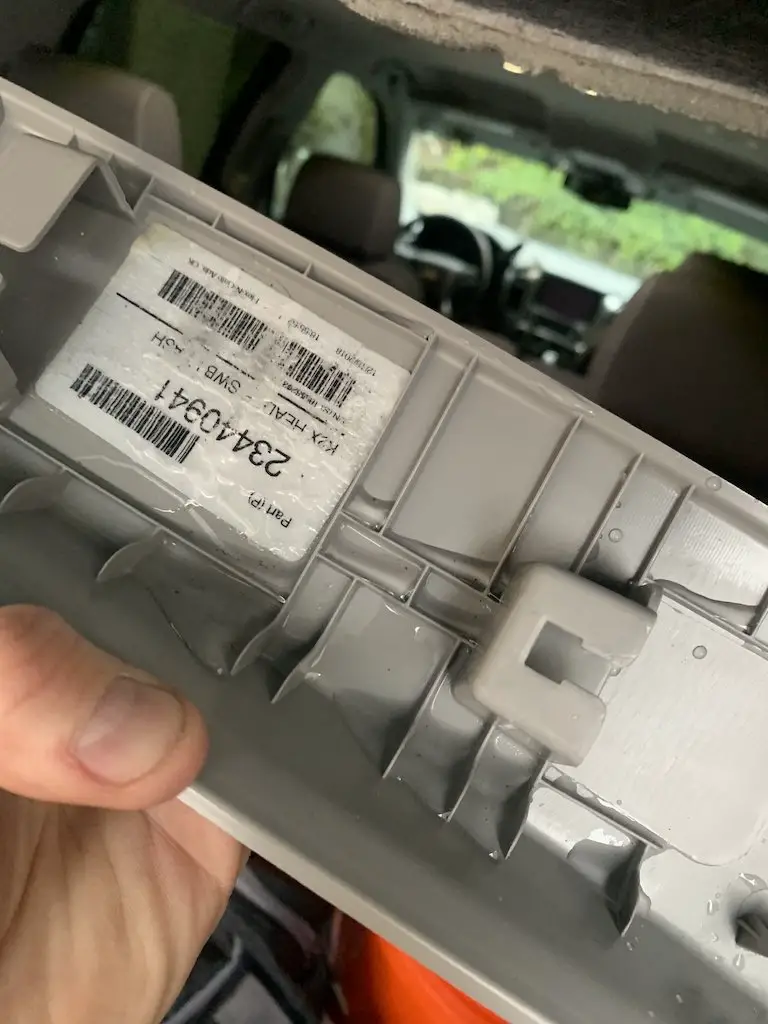

I found water and water marks on the area of the lower D pillar, and when pulling at the liftgate trim some water dropped out.
I removed the trim and found water above the lower metal of the roof.
Upon further inspection I found water dripping out of the connector that connects the body to the liftgate.  I'm presuming the gasket that seals the connector has failed.

I just noticed this on my 2020 Tahoe today... headliner stained in the same exact spot.. I’ve always noticed small amount of water in cargo area after car washes but always thought maybe it got in after opening hatch... only have 9k miles on it so I’m definitely taking it in to see what they will do about it...
