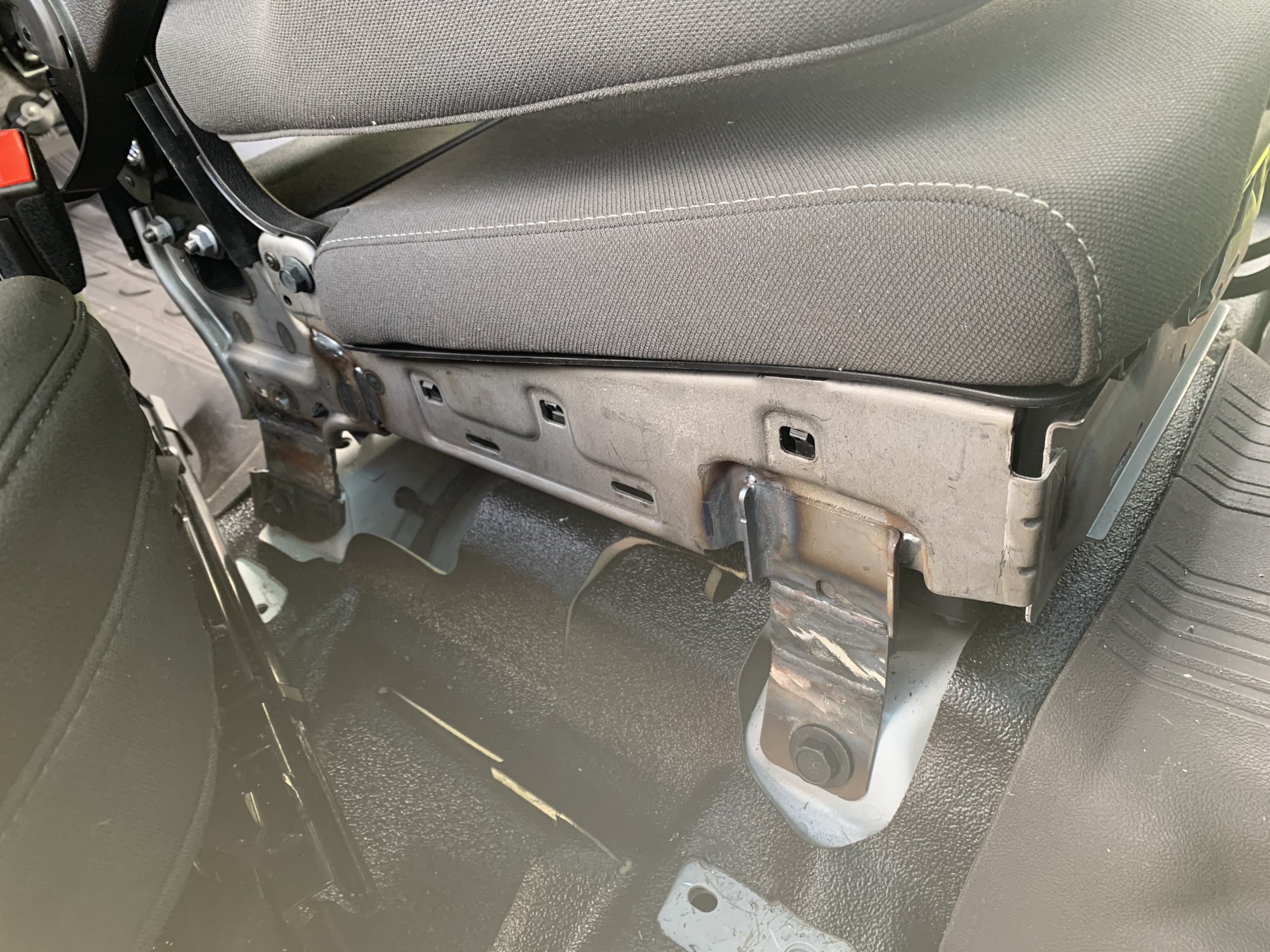

I can't answer any of your questions but I might be able to help. I have a 2020 2500HD Custom. My jump seat had no storage, I had to have storage so I went looking for a jump seat with storage. I ended up installing one with top and bottom storage out of a 2016 Tahoe. It did not bolt in. I had to make brackets out of 1" flat stock. Easy process just took time. I don't have the wiring for all of the charger ports in the Tahoe console but I have them on the dash. To get a direct fit for a 2020 I think you might have to buy one for a 2020. Watch EBay, these Municipalities buy new vehicles and rip the consoles and jump seats out to install their equipment.

Do you have any pics?  I’m doing this exact conversion in my 2500.  Did you weld the flat stock to existing?  Thanks

I got mine done today.  Have a buddy that’s a welder.  We raised the console a little for comfort.  I’m 6’5” and I’ve always disliked how low the armrest is.  Turned out well, and everything is getting wrapped in red Katzkin next week.

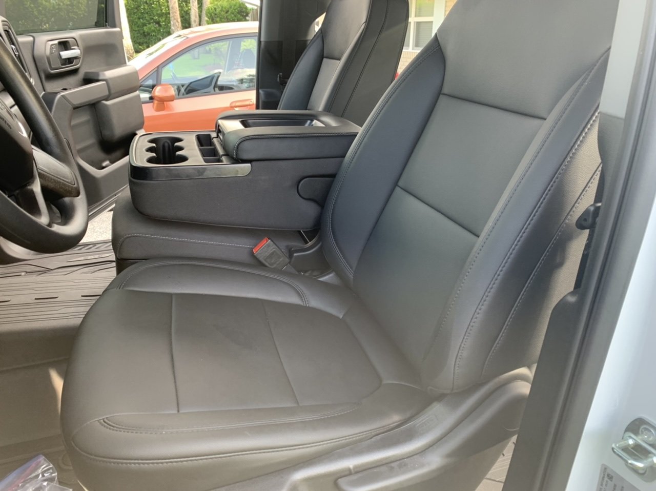

On 1/3/2021 at 2:28 PM, Colin1944 said:
Has anyone successfully converted the 2020 3500 Denali centre console to the jump seat? Would love to see some pics or a how to on it if anyone has pulled it off?
Yes. This pic below is from a buddy that has a 2020 3500hd denali. Converted to the 6th seat all leather. Has storage top and bottom including all the accessories behind it. The woofer was mounted under the rear seats. Woofer can be abandoned as well with no issues to sound system. The seat is from a 2019/2020 which is the new style so it was just a simple bolts out and back in. No welding no issues. Simple swap.
