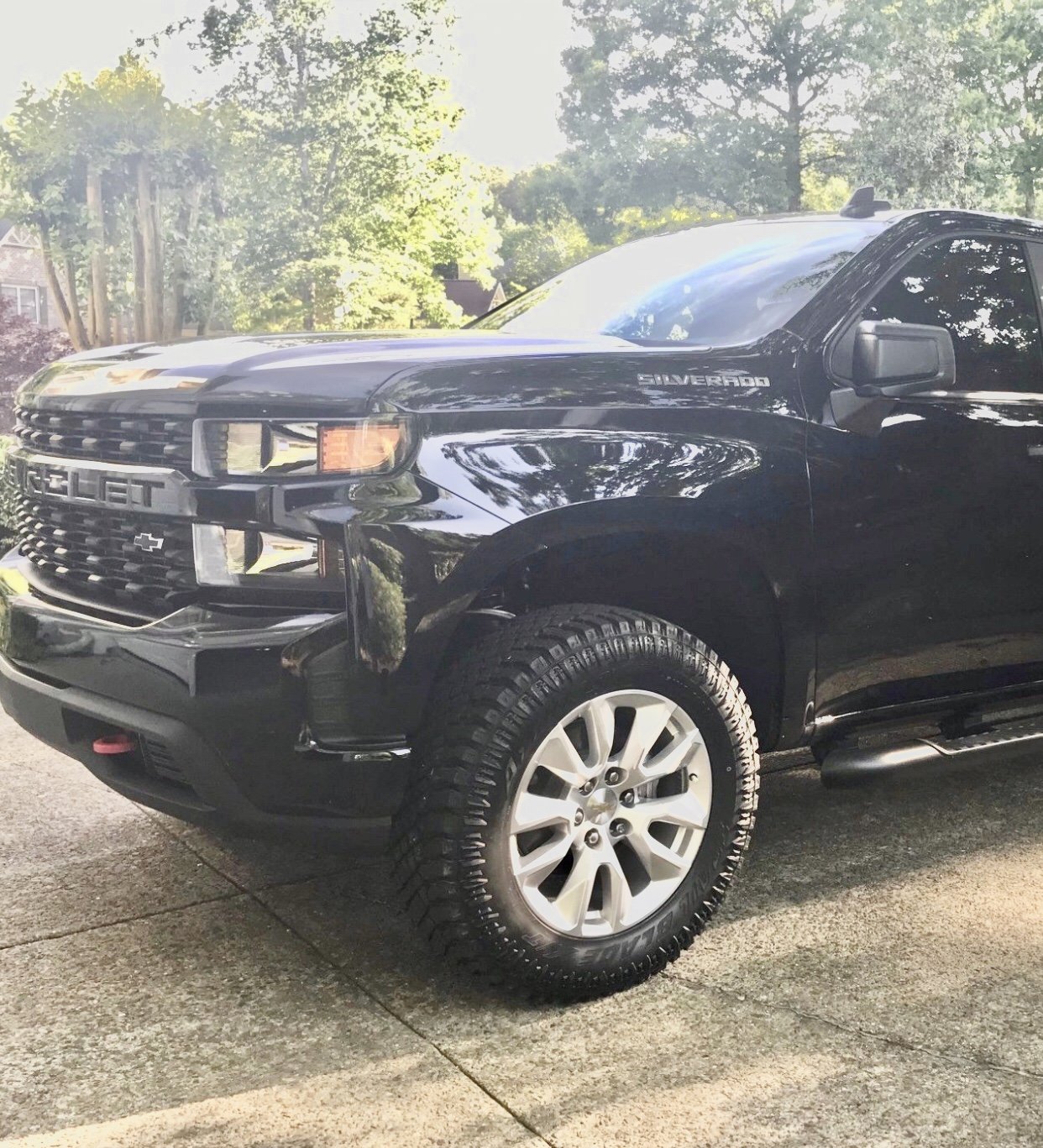

On 5/26/2020 at 6:58 PM, Guy Denuccio said:
Yeah that looks perfect..exactly what I'm looking for " more tire " I appreciate you getting at me with a picture...oh just wondering does the trim PKG matter , rst, lt, custom ?? I've got the custom...truck came with some decent black alloy wheels 18 x 8.5 ya think Maybe I can use them with the 1.5" Lev & the 35" Bfg's ?? Seems every local shop around here (L.A. CA) just wants to push a $6500 lift  rims and tires.. crazy
Hey buddy, seeing as this was just under a year ago, I was wondering if you found at any more info? I have a 19’ Custom Trail Boss as well and most of the infor here is for the LTs. It’s my understanding that the wheel arches should be the same size and therefore what fits the gentleman in the black LT could fit should work for us. But I just wanna make sure before pulling the trigger on wheels and tires that don’t fit. Thanks again.
LT, custom, WT, RST doesn't matter....body is all the same

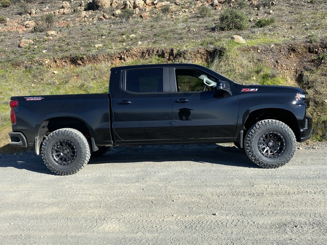

On 6/6/2020 at 7:22 PM, 2019Custom said:

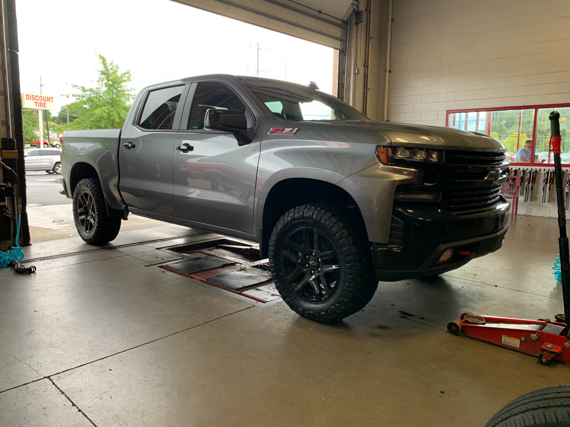

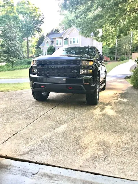

I have a 2020 Custom 4x4 (Not a trail boss). I added a 2.25 procomp level up front and was able to fit 35x12.5s on my stock 20’s. I did delete the flaps/air guards, but have no rubbing even at Full lock.
I had two different (reputable) 4x4 shops say something similar to me about needing a 6” lift to get to 35s. Guess it’s in their best interest to have you spend $2500 getting a Massive kit installed and selling you a tire package for another $2500. Also to be fair to them, ( at least the ones around here) they aren’t very familiar with the T1s yet
I have the tires and stance I want and am all-in for less than $1400

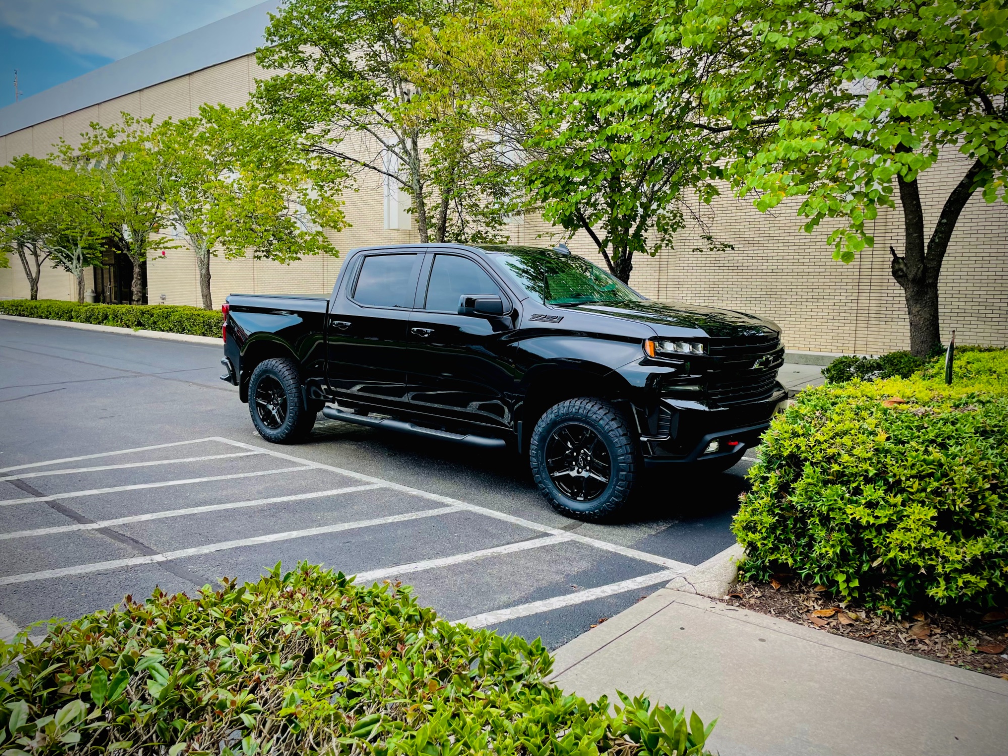

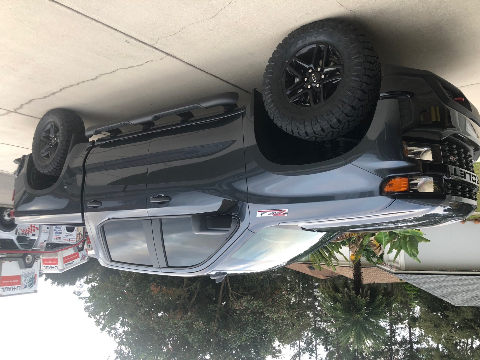

On 6/4/2021 at 10:19 AM, MgoBlue said:
BFG 35X12.5ko2s no rub clear control arm by about 1/2"
Mud flap bracket removed
Bilstein 5100s rear and front set at stock height
Where did you get your Bilsteins from? Looks great, this is exactly what I want to do with my 2020 TB eventually.
Bilsteinlifts.com

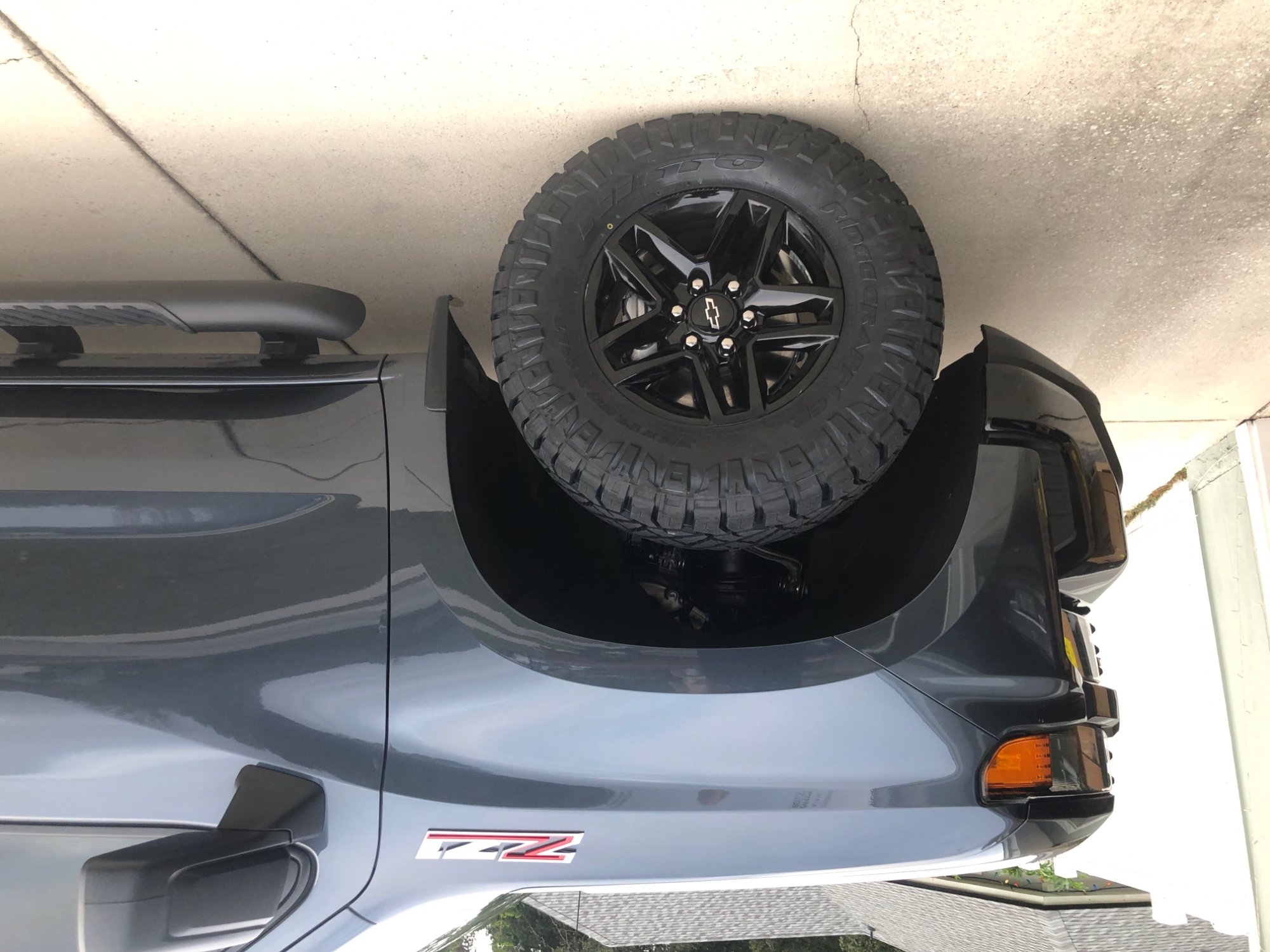

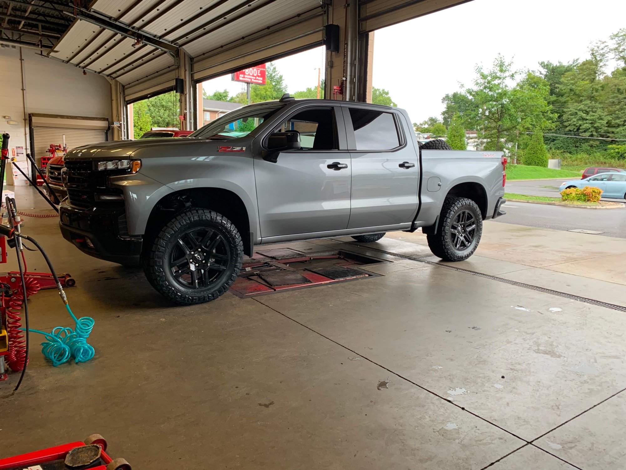

Just got my 2021 Trail Boss. Done extensive research through this forum specifically and I appreciate all the help. I was still very hesitant but I had my tire store put 35x12.50R20 Nitto Ridge Grapplers on my truck before I leveled it. On flat ground, there is ZERO rubbing. It can be done, but I am still going to level for the looks.

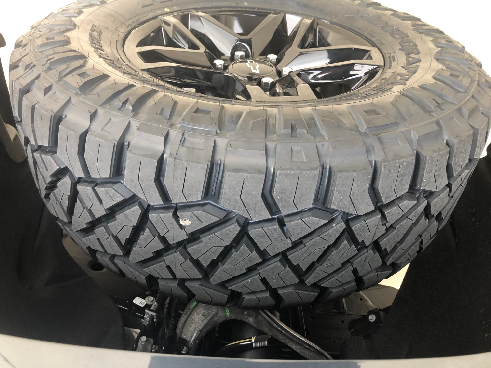

I have a 2021 silverado trail boss with a 2 inch front level kit max racing. I have the factory 18 inch wheels and installed the 35x12.5x18 nitto ridge grapplers with no rubbing problems at all. Very close to upper control arm but does not hit. Just figured I’d post this because couldn’t find much information so just went ahead and tried it and no problems what so ever.
You might want to upgrade your UCA's. It is not recommended to do spacer lifts on a trailboss without upgrading the UCA's. There are quite a lot of ball joint failure pictures out there with spacer only set ups on a trailboss.
