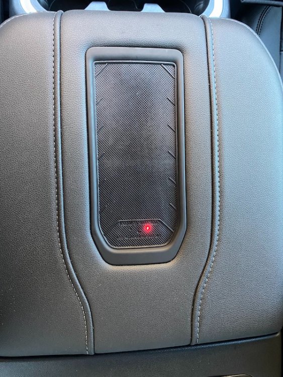

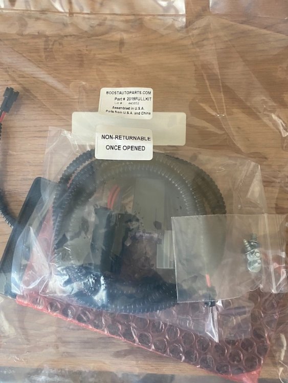

I ended up installing the BoostAuotParts wireless charger over the weekend. Their install video was great. I suck at drilling plastic apparently. Luckily that's hidden and I was able to salvage with a file and razor blade.
The only knock I have is that it resets/turns on every time the truck starts, including from the auto stop. So changing mode to mode 2 or turning it off is pointless until it's going to be sitting a while. I might put a switch on it.

I finally got around to doing this install today, and I'm going to have to do it again.  I blindly took the part numbers that were given in this thread and placed an order with my parts guy.  He got everything I asked for, but one of them doesn't work for me -- the wiring harness.  The harness I ordered doesn't have the connections for SD card reader, so I lost my factory navigation that I upgraded to and installed a few months ago.  Doing some research I found out there's about 4 or 5 different wire harnessed that got used in this area.  You either do have rear heated seats, or don't.  You either do have a wireless phone charger, or you don't.  But, there's nothing mentioned about the SD card in the bin under the armrest.  Finding the correct harness will take a little effort.  Fortunately, I love redundancies.  Not only do I have Android Auto to help me l navigate me, but a recent update from Chevy provided those without navigation a navigation system that doesn't require the SD card and programs module.  It's called Chevy Maps+.  Iirc, I found it in the marketplace where you can add other apps to your radio screen.  It's actually a pretty good navigation system, and gives those with IOS radios but not the fancy instrument cluster the speed limit of the road, and your speed, right there on the navigation screen.

Did you ever figure out which harness you needed? I have the same issue. Harness I ordered has all the plugs needed except the one for the center console USB ports/SD reader
