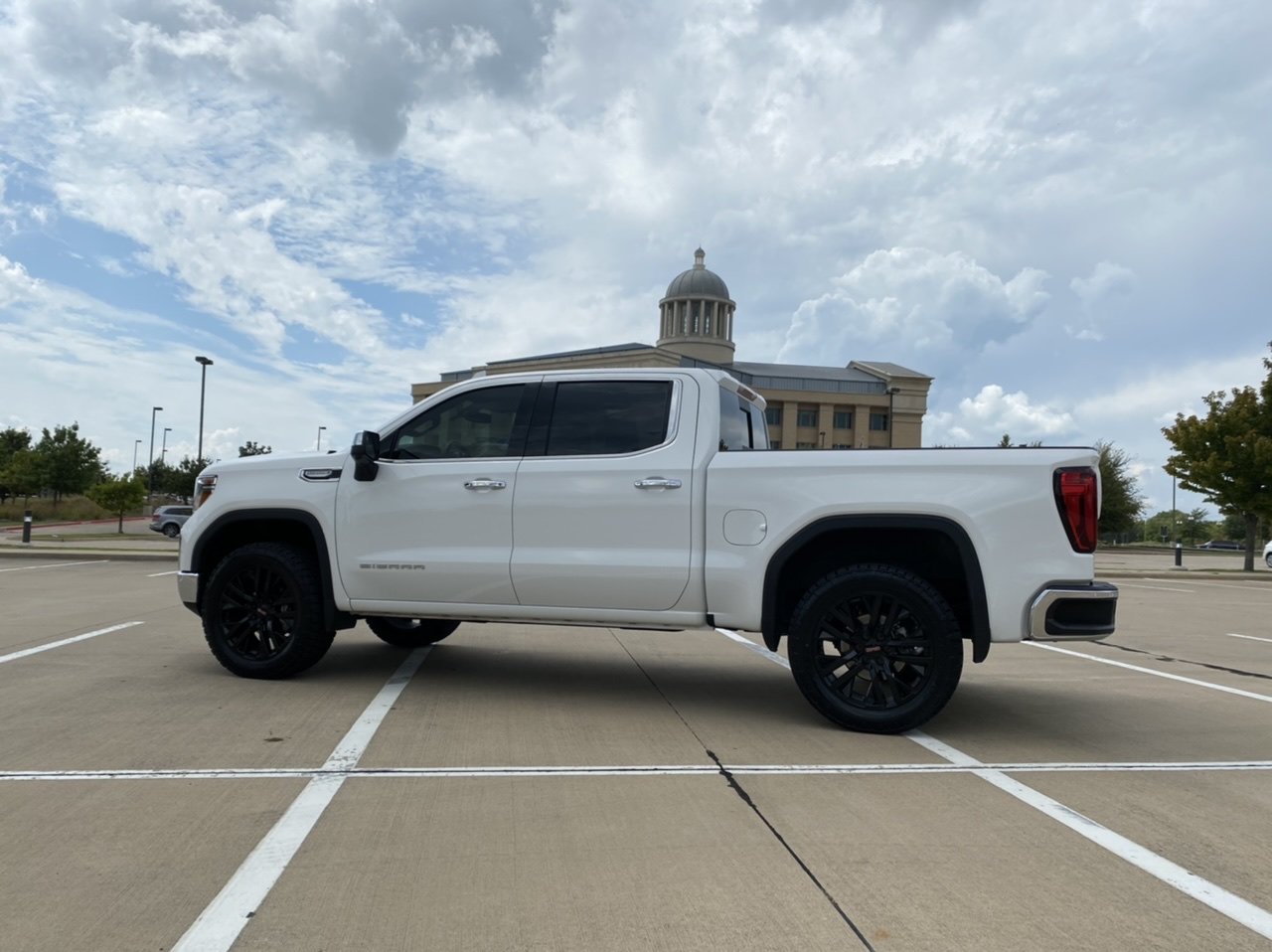

Here is mine. 5100s at max setting in the front, with 5100s and stock height in the rear. I plan to add a 1” block to the rear. 295/55r22 Nitto Terra G2s. Slight rubbing at full lock on the liners. Need to do some slight trimming.

Here is the fender measurements, Bilsteins at max setting, 1.00 ebay rear blocks, and 285/55r22 Terra Grappler G2s.
Driver front - 39.00
Driver rear - 40.50
Pass front - 38.875
Pass rear - 40.50
Stock
Driver front - 36.25
Driver rear - 38.625
Pass front - 36.125
Pass rear - 38.625
Definitely a little more rake than I wanted. I may mill 25% off the height of the blocks to bring it down just a tad in the rear.
Edited by 69gto96z

Your truck looks great!  Thank you for the measurements, looks like it was true to the claimed lift amount. Do you have a side picture to show the rake?  I plan to do the exact same to my Sierra.
Thanks again.
It’s pretty close. Stock tires were 32.9” and the G2 are 34.3”, so about 5/8” of the lift is from the tires. I would say a solid 2.25” came from the 2.50” setting on the Bilsteins. No side shots currently, but I will try and get one tomorrow.
