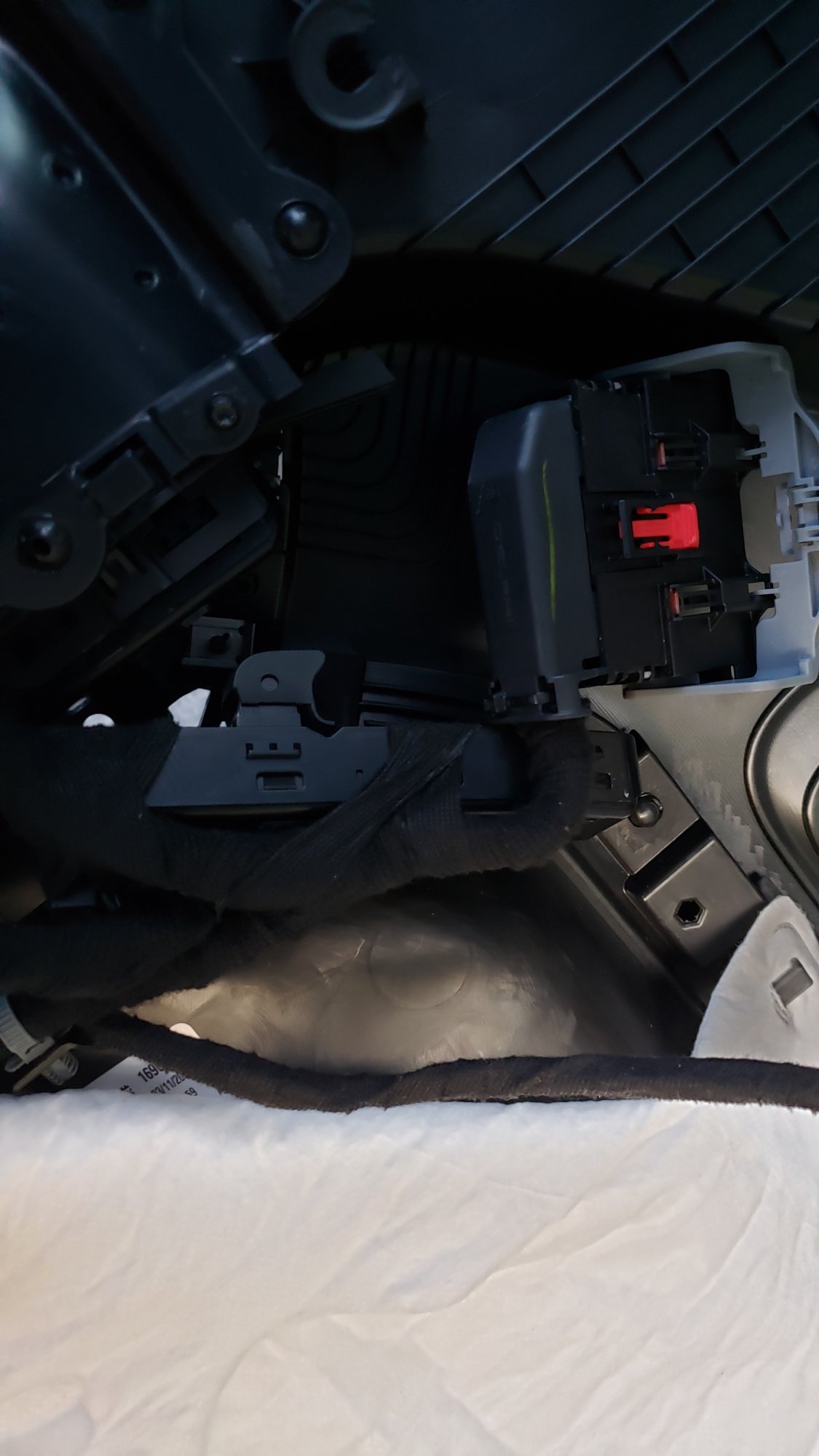

you do not gain auto up/down pass window.  my passenger window was acting up so I made a window switch bypass harness for pass door.  i hid passenger auto up/down switch in door panel to control folding/memory mirrors. I use my original switch to operate window. now everything works good and you dont need a window motor after all, unless you want to get bcm custom programmed.
pic of window motor harness in folder fold memory door.  i cut here and attached my original window control switch harness.
also a pic showing where i hid window switch for memory mirror fold control.
so my passenger door has 2 switches one for mirror folding memory. and one for window up down control.
