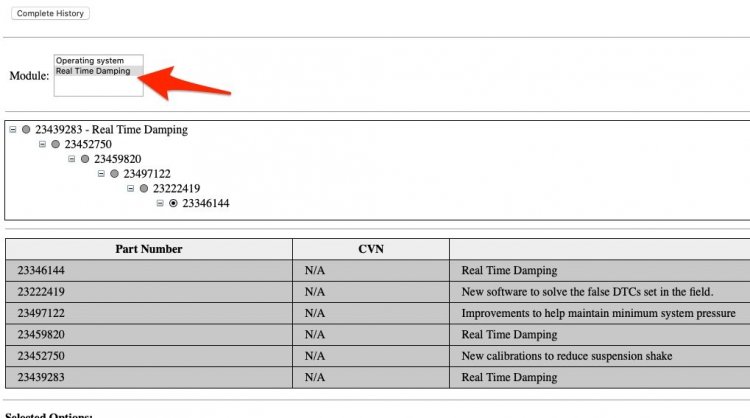

I was looking at calibrations for my 2015 GMC Yukon Denali's ESCM (Z95) and noticed there's a listing but the calibration ID's are not sequential and the latest one it recommends is a lower numerical value than the one that may fix an issue I have. Is this normal? Any explanation for the ordering? I posted this in the K2XX forum but this one appears more appropriate so sorry for the spam. I believe I have the original calibration and think 23452750 may fix my issue. Does the "current"/top one include all the fixes in the below or are they all different and you pick the one that addresses your issue? I won't be applying this, likely taking to the dealer and just want to be informed.

So my confusion on this was the TIS site (which anyone can go to, lists them all and the one I marked "current" in the picture is the latest one but they're not numerically sequential but do seem to be listed from most recent to oldest (top to bottom) as the top one is the one TIS is saying is the current one that will be released/programmed.

I think I may have found the answer.  Previously I went into "Operating system" but going into "Real Time Dampening" it shows what seems to be the progression and they are indeed not sequential
My scan tool won't tell me the calibration ID but my guess is I have 2343983 due to the MFG date and no other suspension programming being done on it.
