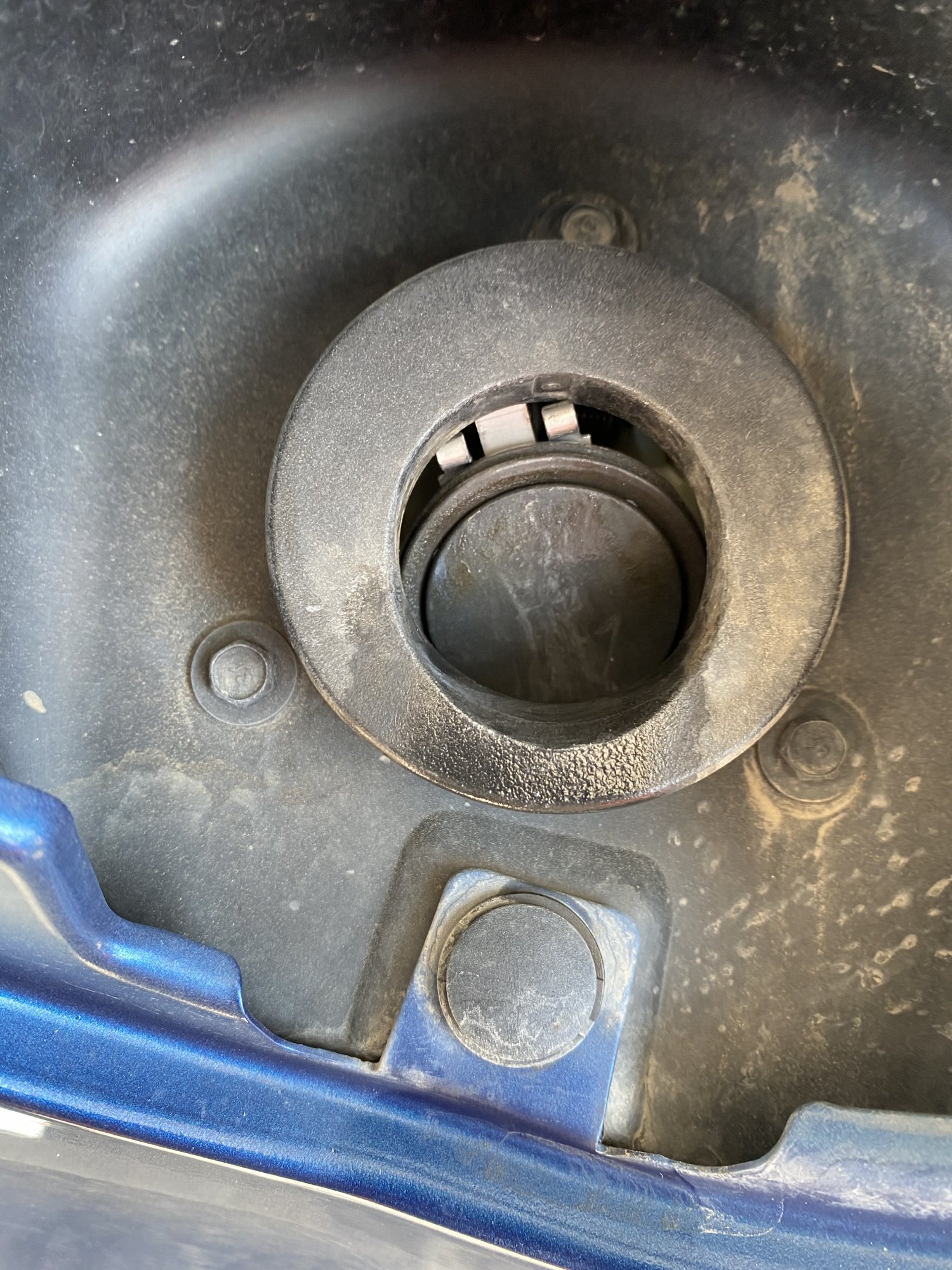

The capless filler flap on my sierra keeps coming loose and sometimes the pump nozzle wont go in easily. I think im out of my 3/36 months warranty. (Bought new 8/2016) only at 34k miles though.
any thoughts?

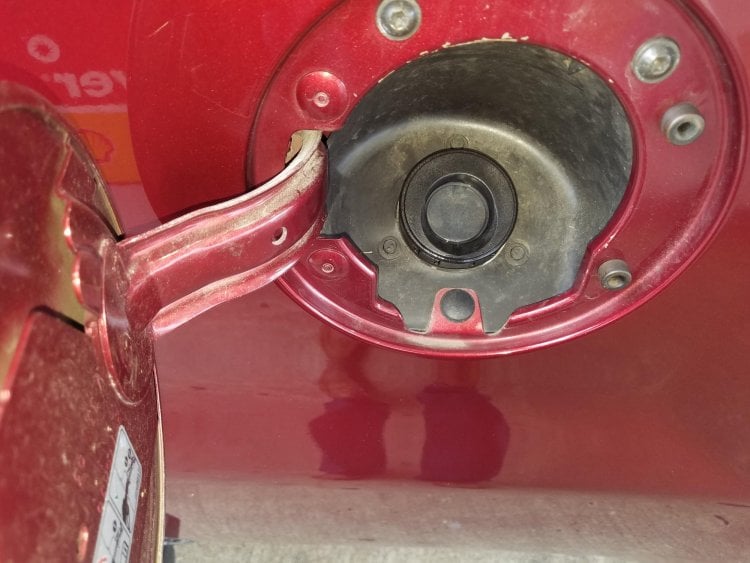

This happened to be on my '17 Silverado back in March. Fortunately, it's a CPO truck & was covered. Once it was fixed, I ended up also putting a cap over it to keep any dirt or water from collecting on top & going into the tank when I'd fill up. Someone mentioned to me that they make a OEM cover that you can put on over it. Not sure what the fix is. On mine they had to replace the whole gas tube neck. Not sure if this is the cover or not. http://ACDelco GT291 GM Original Equipment Fuel Tank Cap
In your case it looks like it just came out of it's holding clip. You might be able to remove the top plastic part & get it back in place.

I just got a plastic spray can top that fit nice over the unit & added a bolt to the top for a pull handle. I still cover the fill cap area even after the fix to keep junk out. Hope this help some for you.

Terrible to see that; I had a flash since my 18 is blue too. It doesn't just clip back up somehow or hardware is broken?  Yeah I put a cap on mine too. I imagine you could buy a trailer hitch cover and trim to fit or a guy on eBay sells them too. I'm not a fan of gas capless system, but it is what it is. Sub'd to see outcome.
I don't think the cap will do anything to prevent my issue though. Maybe rigorous fueling is the issue? I don't know. I'm the only one who fuels my truck. (Wife drives it rarely but never fuels anything.) :) And I've only got 35K in 4 years of ownership. Sometimes my truck sits for a week or more between being driven and town is 3 miles away from home.

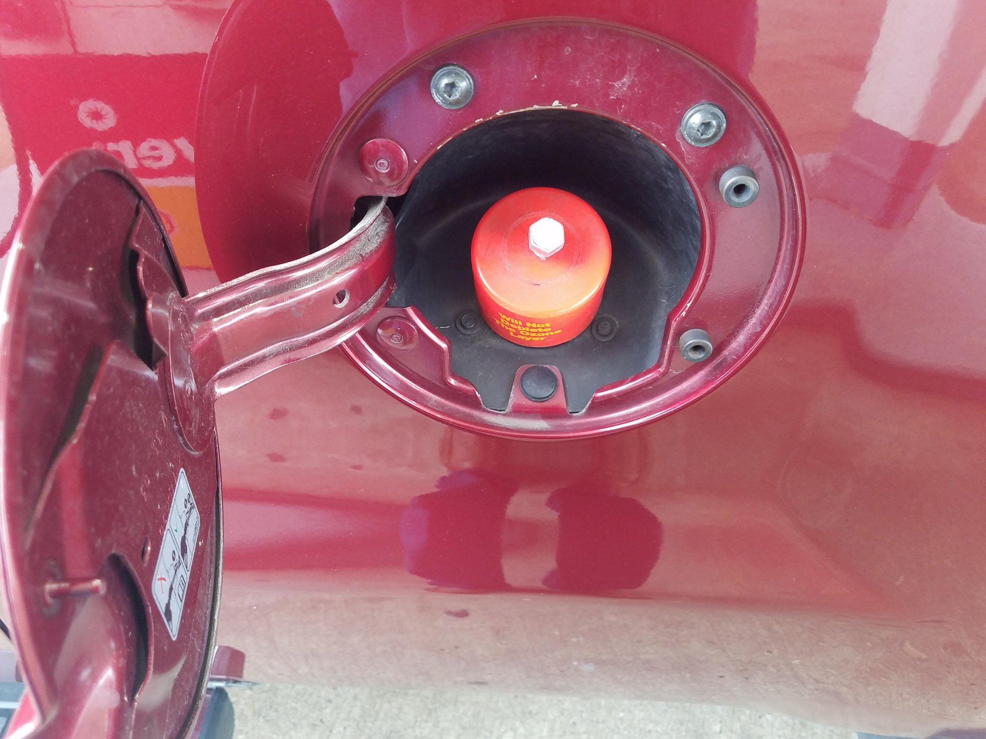

Ok guys...here's my home made 'cheap' version. Don't laugh too hard at me BUT it works great. Keep water & dirt from collecting at the little spring door & going into the tank. Fits snug & pulls right off. It's a McGuyver trick!?
Laundry detergent cap works great for me. A loose fit. I could cut it down so it fits tightly but it’s never moved around since closed fuel door keeps it in place.

I love it!  Improvise  Adapt  Overcome
