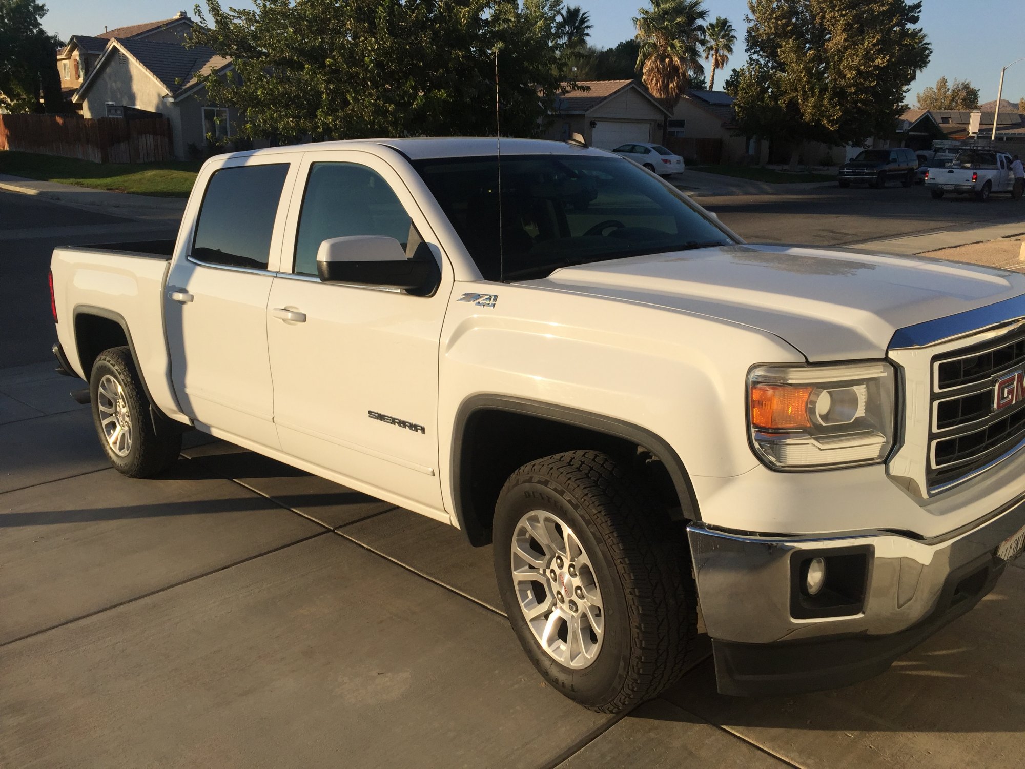

Tire Setup for stock ride (no level kit)
JJC
 Share
285/70/17 approx 32.8” BFG KO2
Bilstein 5100 raised front 1.85” from stock. 1 notch down from max lift on 5100
Very little rub at full lock on upper control arm. could go to a 34” with some fender liner rub or just tie it back.
