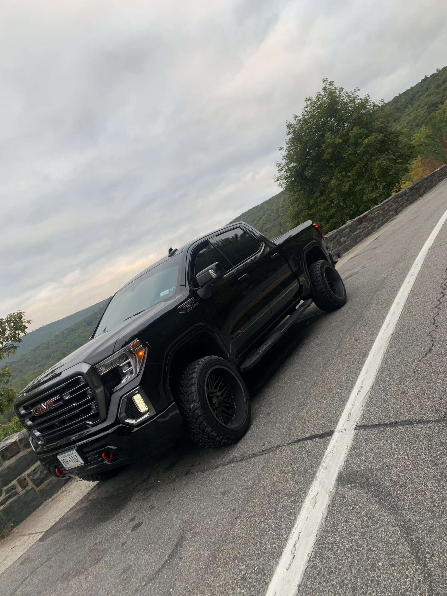

Idk if this will help at all but I have a 2020 at4 1500 with the 2 inch lift from the factory. I added a 1.75” leveling kit to the front and nothing to the rear. The truck sits almost dead even with the back. I used Readlift leveling kit with control arms. If you plan on doing a lift or leveling kit I highly recommend upper control arms. I’m running 22x12 with a -51 offset with 33x12.5 Toyo MTs. The ride quality is unbelievable feels better than stock. I had to do alittle trimming all around mostly cause of my offset. The wheels stick out alittle more than an inch. The fronts have 3/8 spacers. I have zero complaints after a few months with it installed. I drive the truck everyday

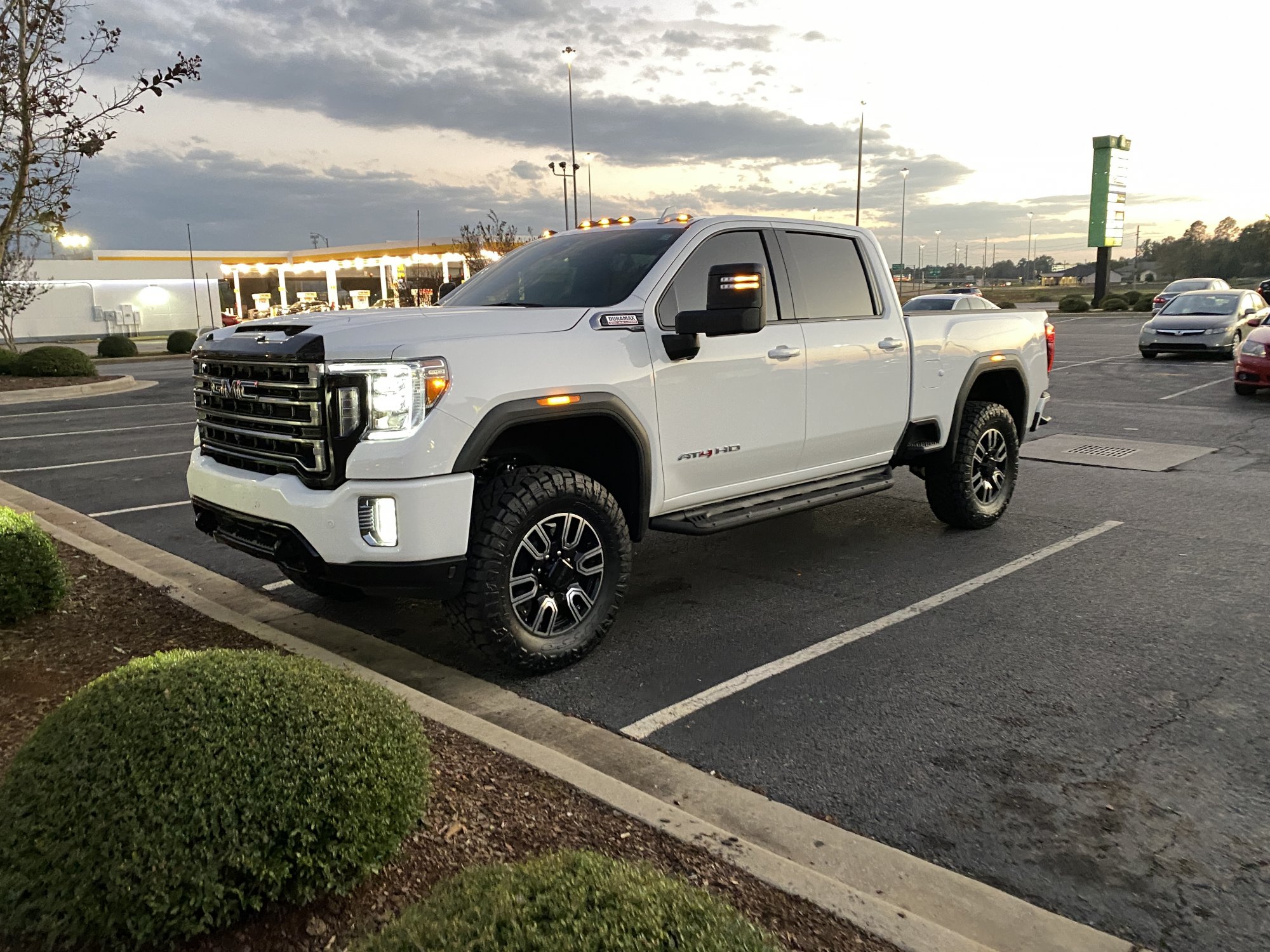

I have the Cognito 3" Premier leveling kit and also added a 1.5" rear block to keep a slight rake. I'm running 37x12.50 Nitto Ridge Grapplers after some trimming on the liner and some trimming on the mud flaps. Well worth it in my opinion to get the look you want.
