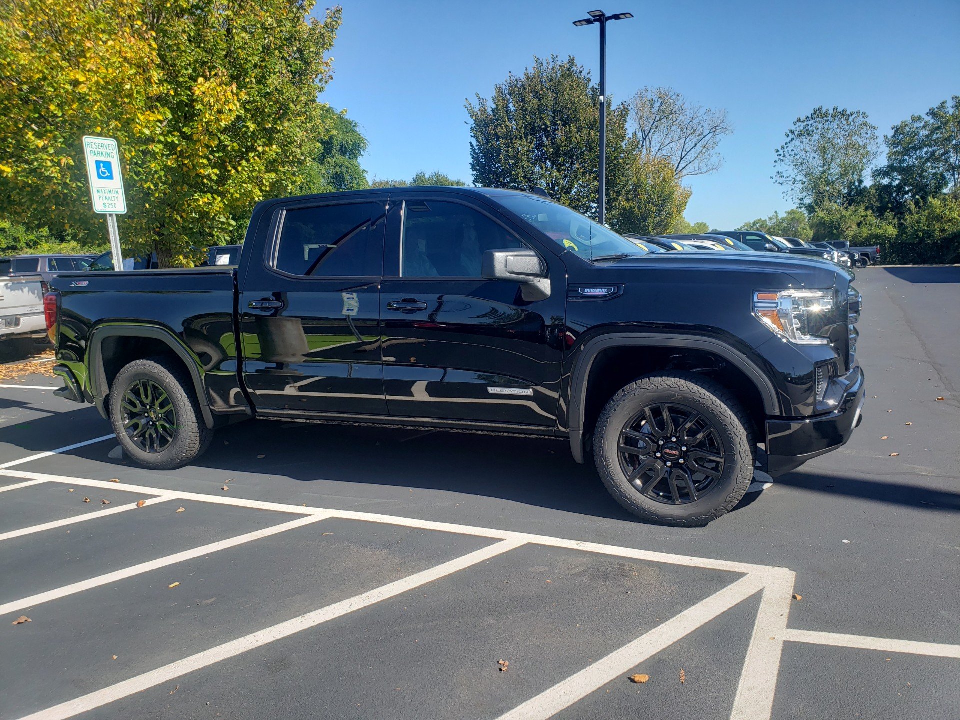

Initially, all I wanted to do was just level my truck. However, after purchasing a leveling kit that gets placed on the bottom of the strut, I read a ton of reviews saying they suck because they put stress on the control arms, so I returned the kit. Since I like the look of the AT4, I figured I'd look at 2-3" suspension lift kits and discovered there are some that aren't that expensive, so now I'm pretty set on going this route. My question is-- do these lift kits also level the truck, and if not, will doing so put the same stress on the control arms as leveling it with the stock suspension? Clearly, my idiocy stretches far beyond searching ****** on this forum...
I was planning to go with Bilstein shocks anyway and found this kit online. Does anyone know if this will also level my truck?
I was also looking at this 3" Superlift that comes with Bilsteins, it's more expensive, but if it does more of what I'm looking for, I'm down.
Call me an idiot, I'm married, so I'm used to it. Any advice would be much appreciated. Cheers!
