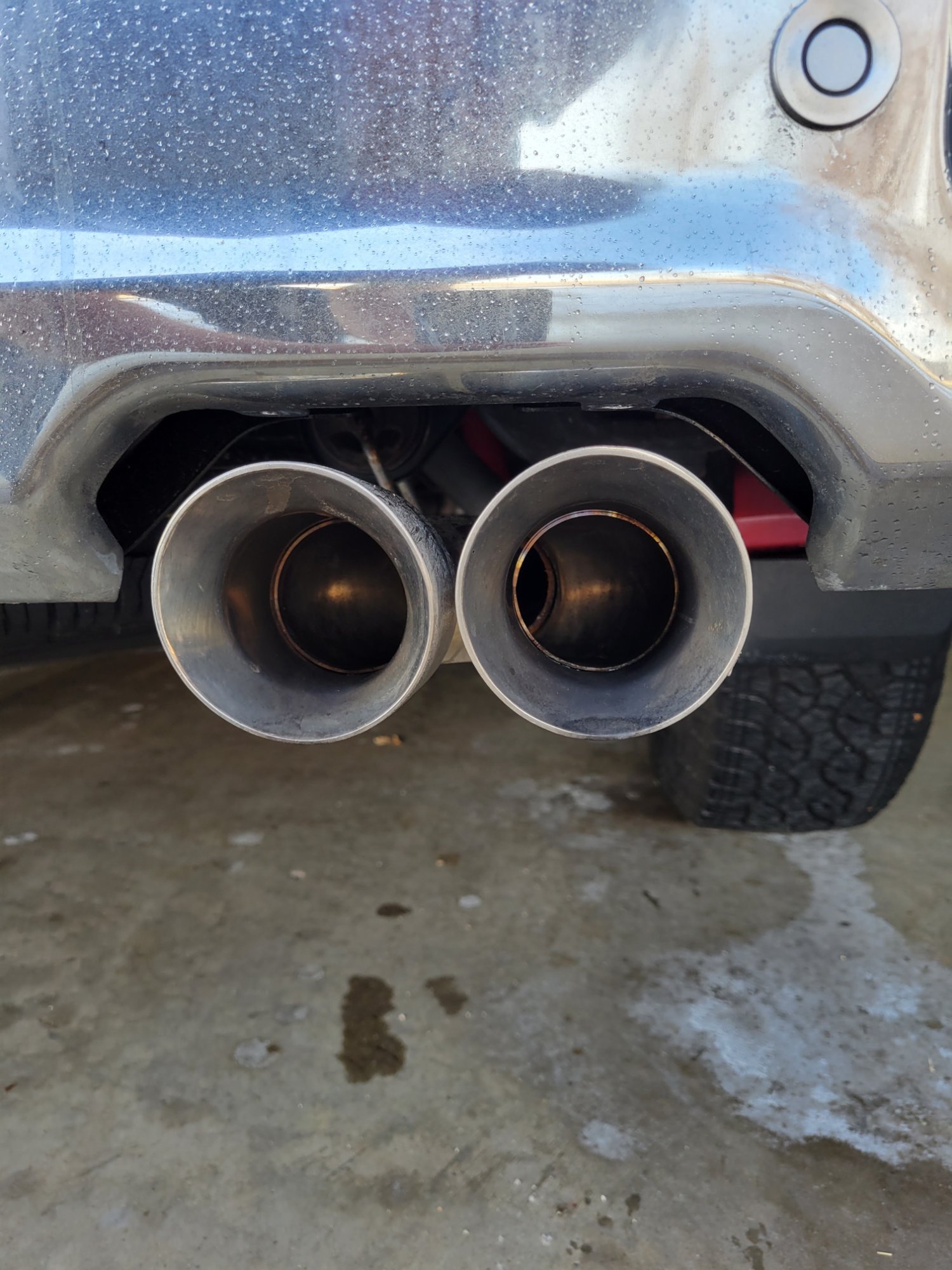

Just had mine done a few weeks ago. These trucks look awesome with quad tips for sure. I chose to use Wesdon tips on my stock exhaust and was very impressed with their quality.
Looks good! After adding the tips did it change the exhaust sound any?
Thank you. The sound did change a bit, especially at startup.  I park in a garage at home and notice the sound at startup is definitely more 'out the back' now compared to coming from under the rear of the bed. Another reason I changed was because the stock tips were starting to corrode and didn't clean up well anymore.

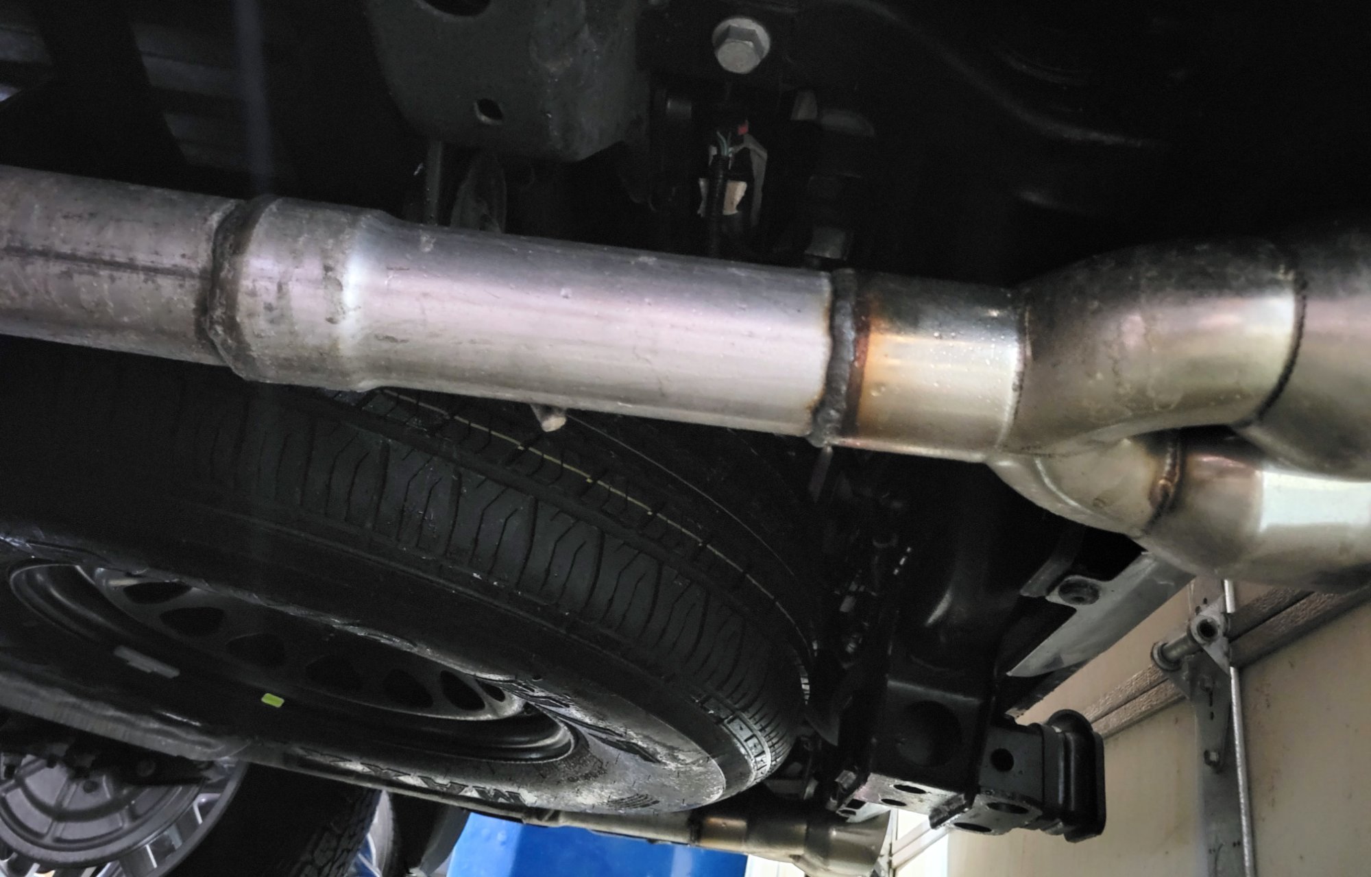

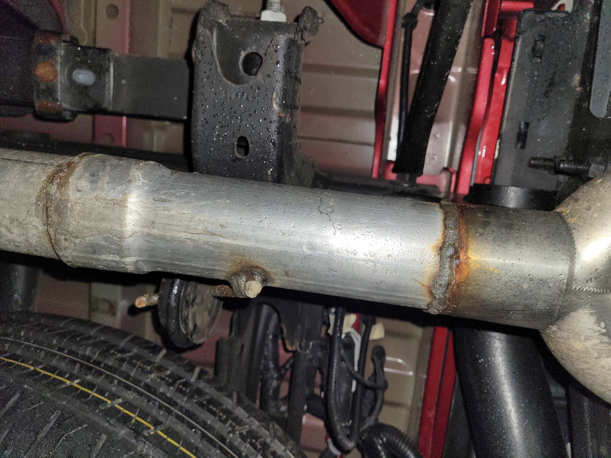

Do you have a link to the tips? These are the exact look I've been searching for, but there's quite a few options on Wesdon's site. Did you get weld on or clamp on? Looks like the stock pipe behind the factory tips takes a little down-turn at its tip, did these fit on that or did you have to modify the end of the stock pipes?
These are the tips I used, although I think 4" would fit just fine. At the time I just wasn't sure:
Exhaust Tip 2.50" Inlet Dual 3.50 X 9.00 Long Round WDWDRS3500950-250-HP-SS Double Wall Polished 304 Stainless Wesdon Exhaust Tip.
One thing I noticed before purchase was the weight -- 4 lbs. each, heavy and solid feeling. I had them welded on by an independent garage that does custom exhaust and they were also impressed by the quality. They cut off about 10 inches of existing pipe before welding on new stainless, and the original hangers were cut off and reused. Total cost was 130.00 plus the cost of the tips.
