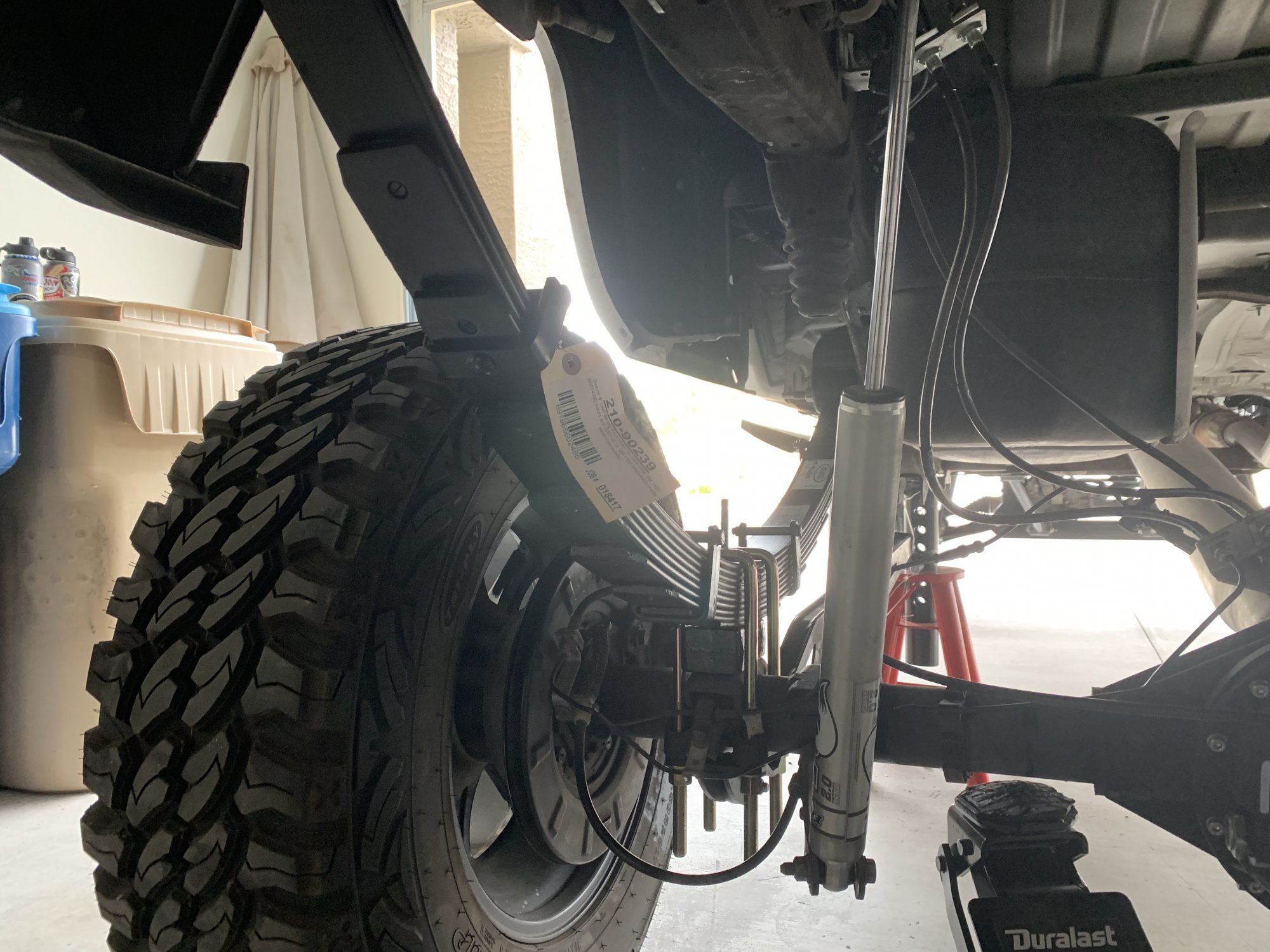

I have a Cognito 10-12" lift with 8" Deaver springs on a 2" blocks in the rear. With that high of a lift I know I need to extend my drive line.  I got a quote of $800 to extend my rear drive shaft an additional 2".  Has anyone installed a longer slip yoke instead of extended their drive shaft?  Found an 8" slip yoke from Speedway and I was wondering if anyone has gone this route.

Well, when I installed the deaver springs the instructions recommends the drive shaft be lengthened.  Rear is lifted a true 10 inches from stock.  I just wanna be sure that I can tow my travel trailer and off road without my drive shaft falling out...
