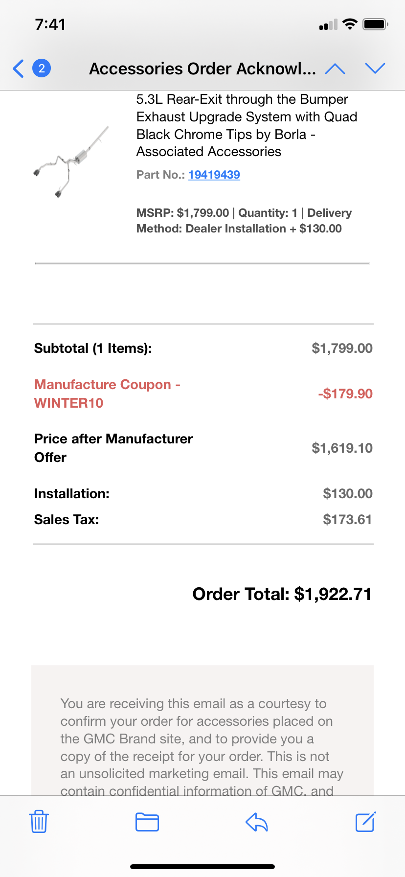

I put the borla cat back exhaust that gm offers on my 5.3 elevation, part number 19419439, and although the quad tips look cool, I think it sounds terrible.  It sounds like I went down there and poked a bunch of holes in the stock muffler.  I am not new to after market exhaust, but this is my first (and last) Borla setup and it is by far the worst sounding exhaust that I have heard.  If thinking about after market exhaust, I wouldn’t waste my money on this expensive piece of garbage.

The dealership installed it.  They used the clamps that came with the system.  I’m confident that they installed it correctly, but maybe I will bring it back to them and ask them to do a once over on it.  Corsa was a good choice.

Yes for sure bring it back to them! That is a lot of money for YOU not liking it. And YES, I love my Corsa. I got it on sale through RealTrucks with a 10% coupon code for $1180 after tax. I also got the S&B CAI for $320. In all after taxes I have right about $1600.  Dealership when I bought it wanted like $2600 to install GMPP. I said no I’ll wait.
