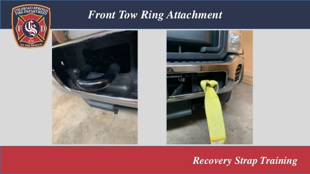

What's the best way to attach a recovery strap, should I ever need to, to these newer GM's with the closed tow hooks with a square shape in the front bumper like the AT4?   Seems like using a D ring it could easily move around because their tow hook is tall/flat in the front and end up being aligned improperly especially with a recovery strap where you are gently taking a run at it.  Only thing else I could think of was just running one end through the closed hook, and thread the opposite end through the loop of the first end and snugging it up (see pic below).    I did check the manual and sadly all it shows is a picture of a giant log chain run through it with the hook attached a few links away, and a statement to never pull on the recovery hooks from the side, or tow the vehicle with them.
Something like this: appraratus-recovery-strap-training-14-63

That’s how I’d do it. Run it through the “hook” and then the end of the strap.

(for context...I am in rigging and material handling as a profession)
The way that picture shows the webbing sling being choked is incorrect. You should let that fire department know that. This is one of the biggest issues with people and towing/material handling. They are not trained and do not go through the effort of researching how to properly tow/recover/material handle, so they do inevitably do things incorrectly. Then blame the product for the failure. 90% of the time, things are fine....because products are usually extremely over-engineered....but the issue is that is gives a false sense of confidence and creates very bad practices. So the day it does matter, you end up with a catastrophic failure that could result in injury or death.
Flat, webbing slings can be choked, but the radius of the object they're choked around must be appropriate for the eye opening. It should not come back onto the eye like that. Also keep in mind that when you choke a sling, you reduce its WLL. And you should never choke around the seams of a sling. It's also kind of a pain to have to pull an entire 20FT strap through itself like that.
