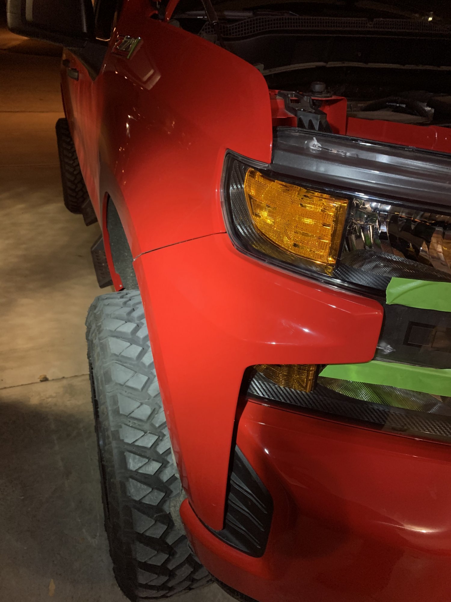

I’m working on my truck and ran into a snag.  How do you remove this part of the fender .  I’ve taken the three bolts I see from the top that you can access through the engine bay and then all the screws that the fender liner screws into it . I’m not sure how to remove it after that .  Looks like there’s few white square body clips but not sure how they come out
I ended up figuring this out .  If anyone else needs to know that comes across this  I can help .
over view.  Remove screws from fender liner , remove 3 screws from top engine bay that connects it .  Then reach inside and pull down on black circle clip that will unpin two pins from top of the clip .  Then pull towards yourself where it has two pins  the headlight connects to it .  It just pulls out of there similar to the grille does.  Then lastly there is two square white clips at the bottom of the fender cover and the cover you pull down on it and it slides down out of the clips

I was doing a headlight conversion on my custom Silverado to the HID LED headlights and ran into a snag when I couldn’t figure out who to remove those pieces .  In order to access the headlight I had  to temporarily remove it while doing the headlight install. Once finished my headlight conversion  I put it back in place .
