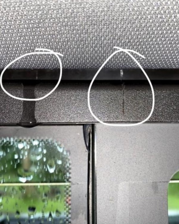

With the window leak, we are talking about a 200+ page thread spanning 3 model years. The scale alone indicates a fairly widespread issue, since the number of forum users represents only a very small fraction of owners. Every day there’s at least one new post of a window leak in the Facebook group too. A lot of times the issue just goes unnoticed and there are many who never know there’s a problem.
By the way, it is NOT the spoiler. You cannot find one single case in 200+ pages of a solid rear window truck leaking, but those trucks have the same exact roof spoiler. The only way that is even possible is that the rear sliding window is the leak source. The frame cracks and leaks. It’s well documented here and in GM’s own TSB.

That’s because the window frame is cracked and they are told to use seam sealer across the top of the window as per the TSB. Many of them make a mess. That’s why this issue is even worse.
But at any rate, they aren’t siliconing the spoiler because that’s not the leak source. And they aren’t still installing spoilers without seals on the 3rd model year of production. That would be silly.

More often than not it seems to crack after the truck gets some miles on it. Have heard of some that leaked right off the lot but not too many. Mine for instance waited about 8 months and 8k. Visible cracks in both upper corners of the window frame. They did the sealant fix, messed up a bunch of stuff and it lasted about a year. I have a slow leak now I’m just leaving be.
My point about the spoilers is that if it was a significant cause of leaks, why would it only leak on the sliding window trucks, right?
Best theory I have is that flex in the cab breaking the sliding window frame at random. Solid window trucks have the benefit of a single piece of glass, and no frame. Much more stable and “structural”. No leaks.

So, is it typical that the cracks can actually be seen when it happens or, is yours just a really bad case?
