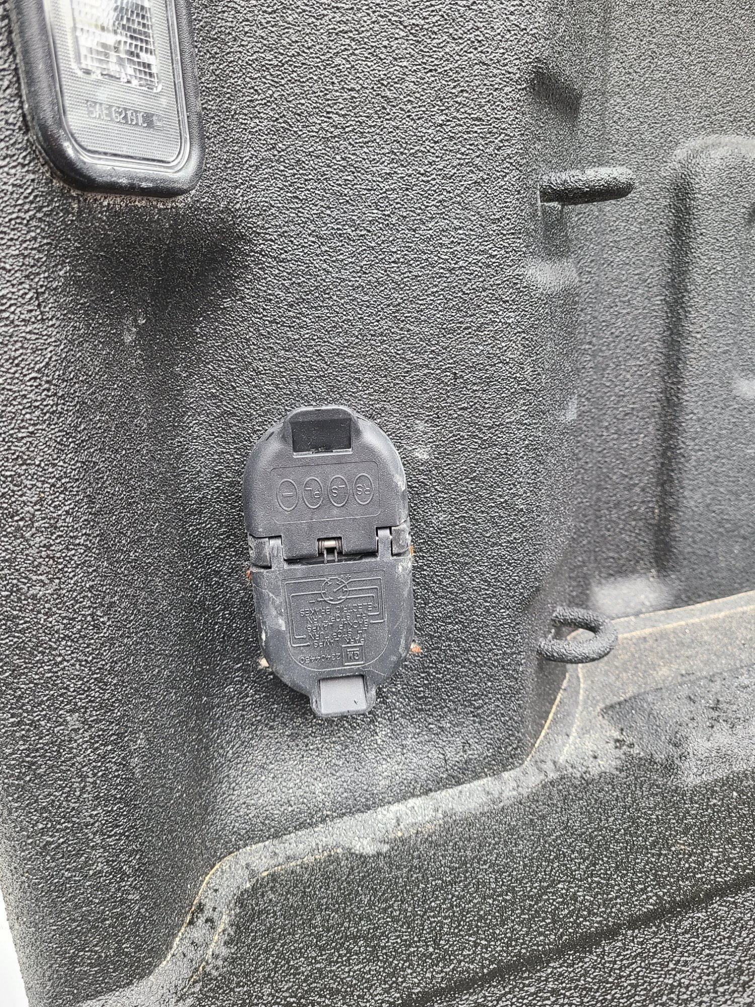

@tortiseshell, yes - that spot is an opening where it can go. It should just pull off of there fairly easily (maybe with a little help from a flathead). I got one added in the same spot on my truck. I had the shop wire it up for me when I had the B&W turnover hitch installed in the bed.

This is exactly what I have as well.
