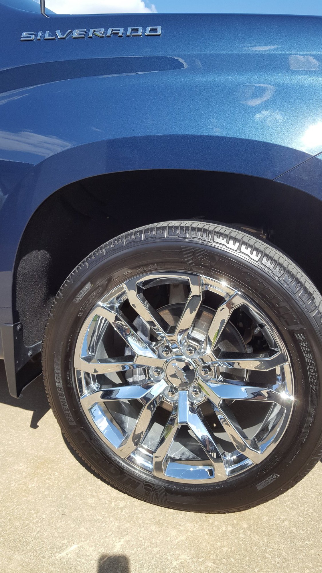

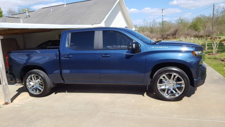

They'll fit.  As long as it's a wheel for 2019 up.  2018 wheels don't work because of the larger 4 piston calipers on the '19. Here's my 22" wheels on my 2019 RST.
