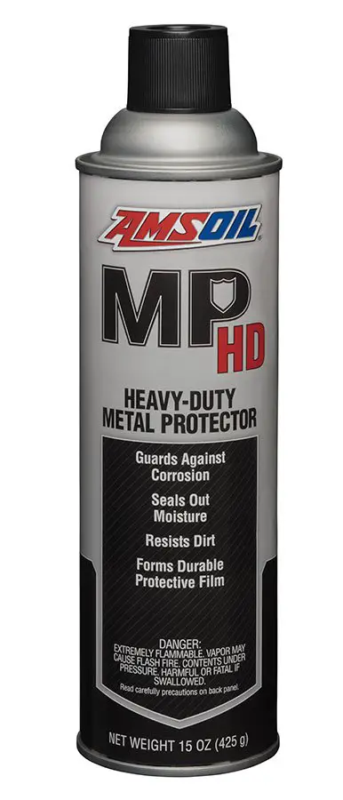

I have a few customers that really like AMSOIL's HD Metal Protector.  It will not effect the factory coating and dries to a wax like film.  If you are interested let me know.  I can get you a quote.

HD Metal Protector is a long term backorder

Sorry, this item is temporarily out of stock due to high demand and supply-chain disruptions. Check back soon for updates.
Not good.  Just like the oil filters.  Hopefully things will turn around soon, but not looking good.  I wonder if all those cargo ships off the coast of CA. will help?
