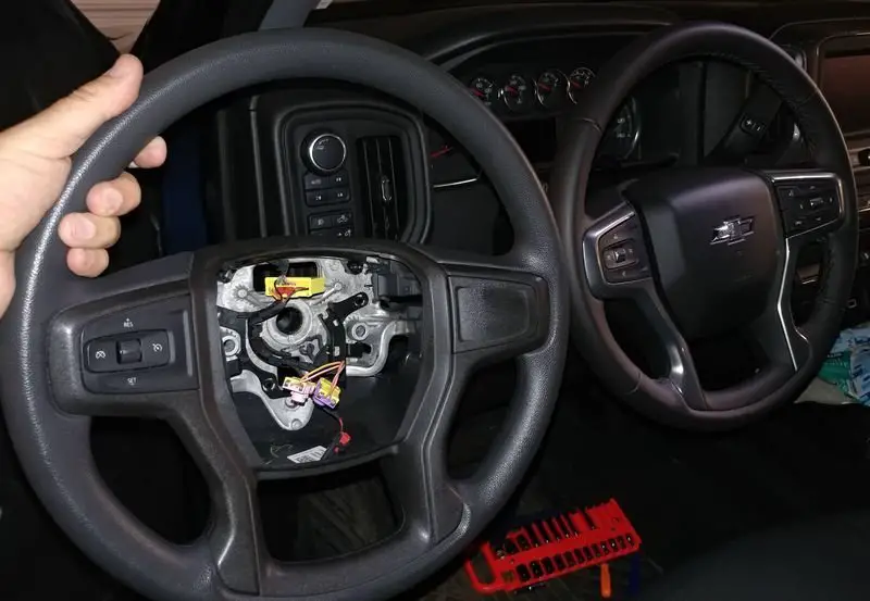

Upgrade complete on my 2020 Custom Trail Boss!  With the help of the Harness Dr's instructions, I was able to figure out how to get the wires landed where they needed to be.
Unlike everyone else that I saw post on here, I didn't go with the full-digital High Country gauges, instead, I went with the more traditional (and cheaper) gauges setup that has the color LCD in the center, and the four physical gauges up top.  I like the physical gauges, and the silver trim on this cluster looks nice.
Overall, I'm blow away by how much this upgrade improves the feel of the truck.  The cheap foam steering wheel with the big blank panel on the right (instead of buttons) just screamed cheap, as did the monochome LCD in the center of the gauge cluster.  The look and feel of the leather wheel is awesome, and I'm surprised how much better the gauge cluster looks.  The wider display and the addition of color makes it look so much nicer!  The trim on the steering wheel and the new gauge cluster  trim looks good with the silver trim around the radio.
But the main reason that I did this was, was to get the steering wheel buttons, and I'm not disappointed.  The microphone button is great to bring up my Google assistant, even when I'm not running Android Auto, and my biggest pet peeve with the IOR radio before was that when I was in Android Auto and listening to the radio, there was no easy way to change between my presets.  I had to hit the home button, and navigate back to audio and press the new preset button on the top of the screen, then press and hold the home button to get back to Android Auot!  Now, I just press the buttons behind the left side of my steering wheel.  And just activating the Google assistant required reaching all the way over to the right, and pressing the microphone icon, which pretty much made you take you eyes off of the road.
Special thanks to WAMS for making this possible.  My 2020 Custom Trail Boss with 5.3 and without start/stop indeed works with the "2021 US Spec GAS - Chevrolet - NO AUTO STOP" gauge cluster that he had me order.
Anyways, here are two pictures.  One comparing the stock wheel with the new one, and one with the new wheel and gauge cluster showing.

I just wanted to update the thread on how this upgrade has improved the daily "quality of life" when driving my 2020 Custom Trail Boss.
Instead of feeling that crappy foam steering wheel (and the defect/nub I had on the back of mine at the 12 o'clock position) in my hands, I now have a nice leather wrapped wheel and it makes a big difference when driving the truck.  The trim color on the steering wheel that I chose, seems to match the factory trim around the radio quite well.
What surprised me most is how much I like the new color gauge display in the center.  I didn't realize how lame the Custom's monochrome display was until getting this.  When using the cruise control, seeing the symbol in green lets me immediately know that cruise control is enabled, which wasn't so easy to see on the old display.  Just having the time displayed there makes it so much nicer than looking at the stereo, trying to find the time, especially when android auto is running.  I wish that there was a way to also display the outside temperature next to the time, but there doesn't appear to be a way to do that.  While I didn't get the mostly digital high-country display, the display that I got is quite nice, and I like the shiny trim around the physical gauges.
And of course the buttons are what I was most looking forward to, and I'm not disappointed.  Being able to hit the microphone to bring up the android assistant, instead taking my eyes off of the road, to look at the bottom right corner of the android auto screen is so much better.  And my pet peeve of not being able to easily change radio presets while running android auto has been addressed.
It's a great upgrade and thank you so much for those that found out how to do this, and those vendors who sell the parts that I needed to make it work!
