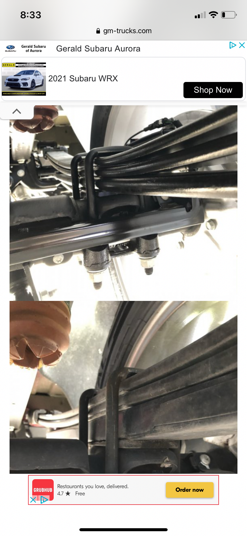

Maybe in a Subaru, but I don't believe that's the case in our trucks.  On mine it appears that the bottom leaf is a composite leaf, while the one layered on top appear to be steel.  The only way to be sure is using a magnet, which I have not yet done myself.
