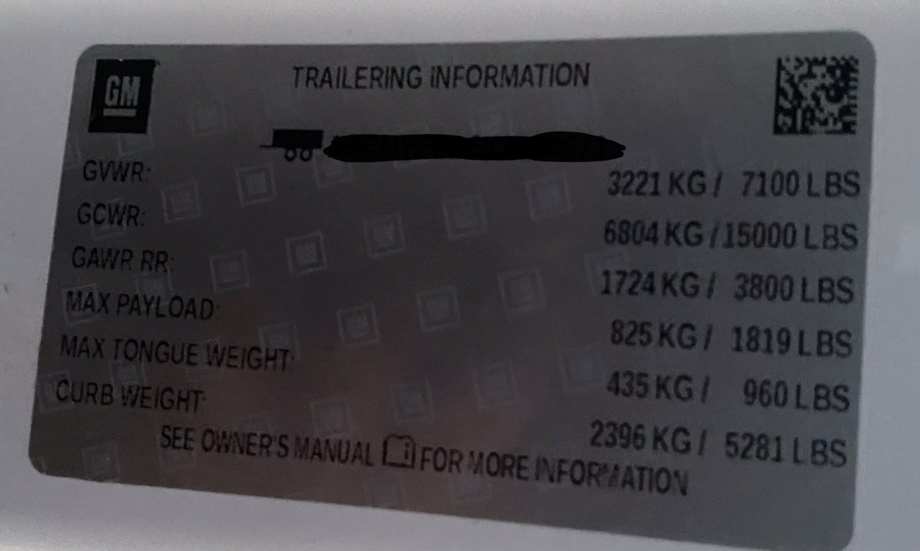

I am currently in the market for a camper and I am wondering how much weight I can tow. I have 2019 Silverado 1500 RST 5.3 V8 crew cab short bed. From what I can find online I should be “okay”, but really wanted some feedback from those of you that have a similar setup. I am aware the 2500 is the ideal setup, but that will be down the line a bit for me.
Truck Trailering Info:
GVWR 7100lbs
GCWR 15000lbs
GAWR RR 3800lbs
Max Payload 1819lbs
Max Tongue Weight 960lbs
Curb Weight 5281lbs
The camper I am looking at has a dry weight of 6300lbs and GVWR of 9,480lbs (no intent to load our camper down or travel with full tanks). Hitch weight of the camper is 680lbs. 32’ 11” tongue to bumper. Really only looking at going camping within 100 miles on the weekends.
We typically travel light with basic necessities for hook up campgrounds (clothes, food, chairs).
any help would be great!

1 hour ago, Bcoyle21 said:
Just wondering If I am calculating the “max” towing capacity of the truck (google and vin checks are not consistent). From what I can tell it is 9500lbs***. Does that sound correct?
My 2020 LT 5.3L has 9600lbs listed on the sticker for max tow weight, with 960lbs for max tongue weight (10% of the max tow weight).  Not sure why your sticker doesn't show the max tow weight like mine does.
Does the other trailering specs match your truck?
Edited by Bcoyle21
2019 stickers didn't have the tow rating; they made you do some math off the numbers on the sticker. GCWR - curb weight comes out to be around 9719 lbs on the sticker shown above (but that doesn't include the weight of a tank of fuel).  But most of us use the 10% tongue weight estimate, so a 960 lbs tongue weight rating would be good for 9600lbs max tow rating.
2020's changed up the sticker to include actual tow ratings.
