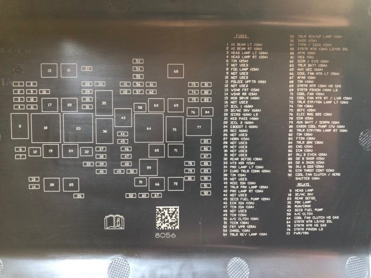

On my truck the fuses for the “PRK LAMP LT” and “PRK LAMP RT” are the fuses for the fender flare marker lights, the front corner marker lights, and the roof marker lights. They are fuses 34 and 42 in the main fuse box on the driver side of the engine compartment. Here are some pictures.
I suspect if you look hard you may find a connector in the engine compartment or fender area that would disconnect the roof marker lamps. I would start by following back the wire for the left flare light.
