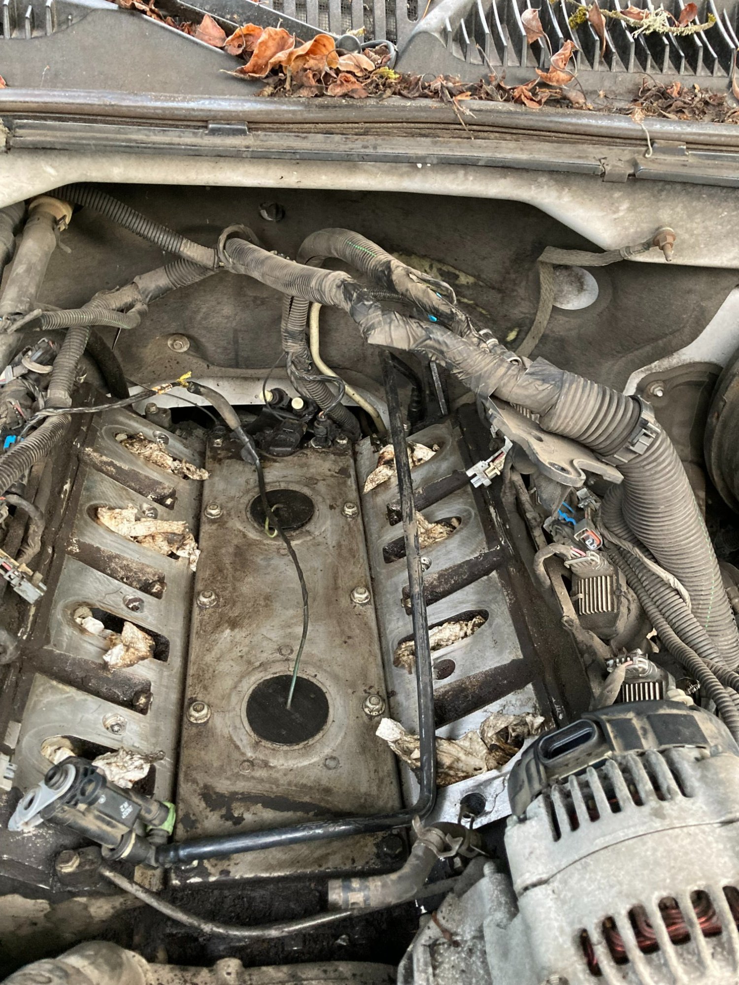

Ok,  so I chose the route of removing the intake manifold and replacing the manifold gaskets and the fuel injector o-rings.
I will figure out how to best clean the injectors.  I will test the Knock sensors to see if they should be replaced.
There is a layer of greasy dirt deposits where the manifold rests on the engine.  Also, more greasy deposits toward the top of the the engine.  What are some candidates for what is leaking?  What else should I check/replace while I have the manifold off?

I could use your help again.  I am super frustrated with myself.  I replaced a bunch of things and now the  engine symptoms are worse!
Current status:    At 600 rpm the engine misfires every 2-3 seconds.  The engine sounds normal when I rev the engine  to about 1500 rpm, maybe lower.  Bank 1 and bank2 LTFT were at +14%, now they  are at 25%. Short term FT can get as high as 50%.
Current codes: P0300 - random misfires detected  - This code is new
P0171 and P0174:  Long-term fuel trim is outside of normal range.
What I have replaced since the last update:
O-rings on fuel injectors,  throttle body gasket, valve cover gaskets, both knock sensors with OEM parts, air intake manifold gasket.  Gaskets were good quality from Fel pro.

- I could now inveset in a smoke machine, or replace parts that probably needed replacing anyways, and hope the vacuum leak disappears in the process.   I went ahead and replaced the valve cover gaksets, the fuel injector o-rings, throttle body gasket, air intake gaskets, valve cover bolt & grommets, both knock sensors.  The gaskets were good quality (Felpro), and knock sensors were OEM.  I have read way too many stories of cheap knock sensors failing early.
-After putting everything back together and starting the engine, the engine mis-fired every couple of seconds and the LTFT had jumped to 25%.  Ugh!  In addition to seeing codes P0171 and P0174, I had P0300  (random misfires).
-I bought a smoke machine.  Running the smoke machine revealed that the rubber sleaves at the ends of the PCV hose were cracking on one end and split open on the other end. Also,  I had left one bolt out of the intake manifold (smoke was pouring through the bolt hole).
