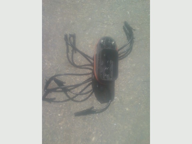

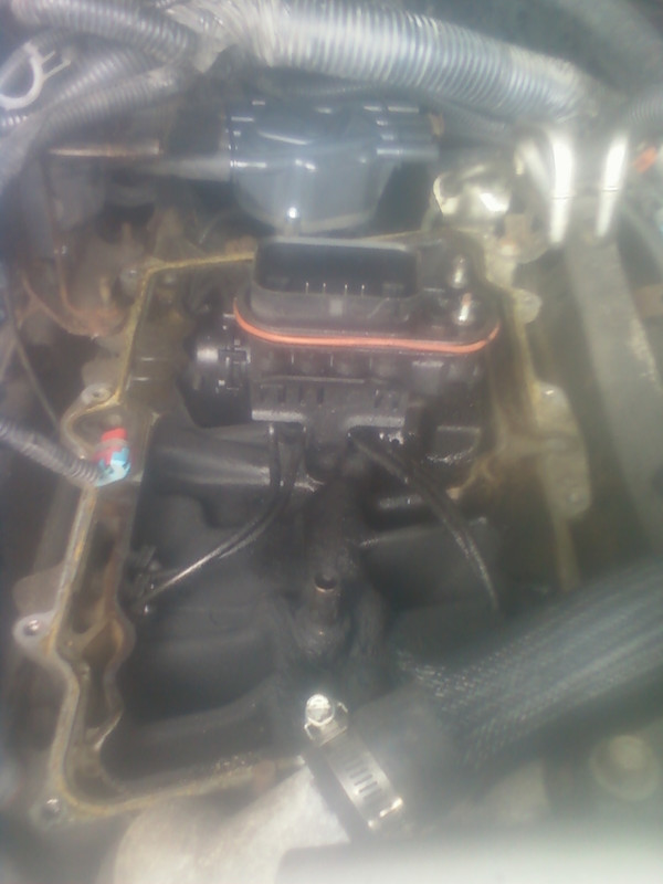

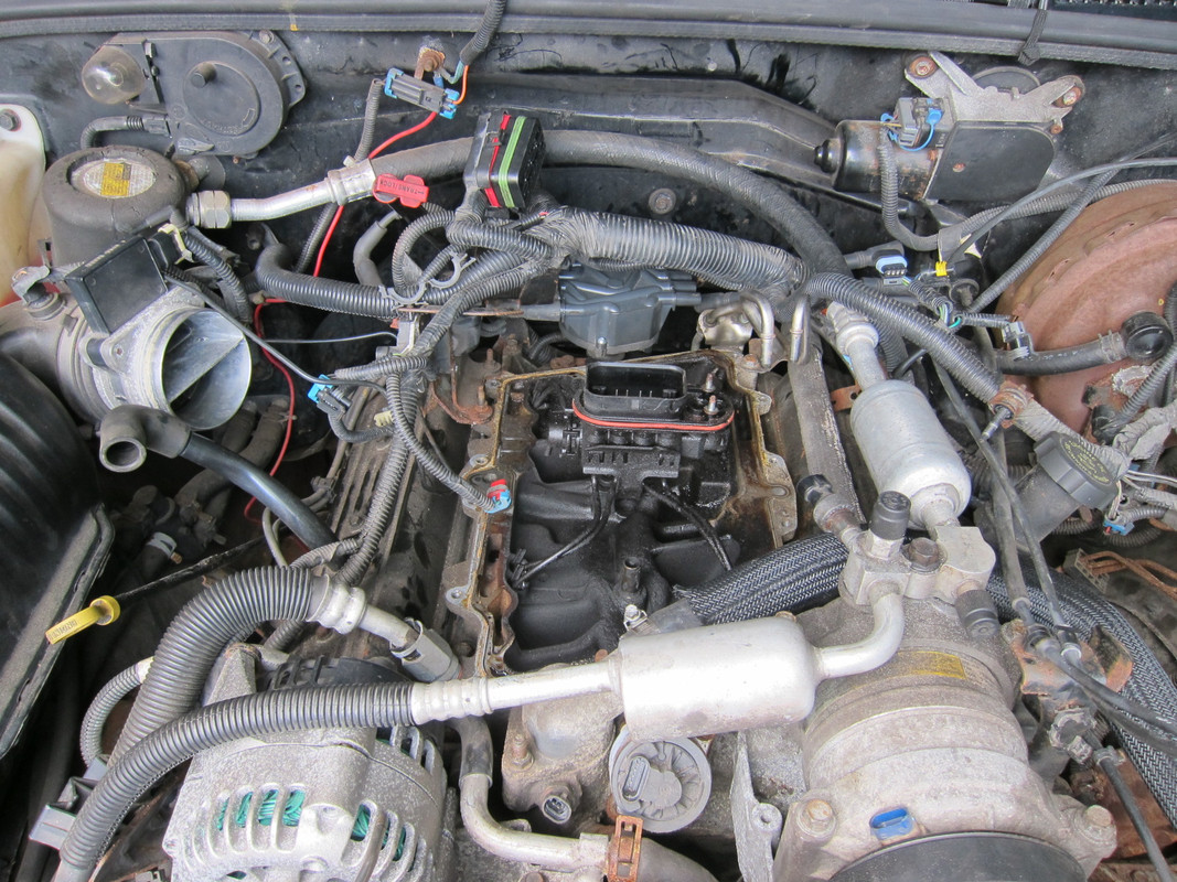

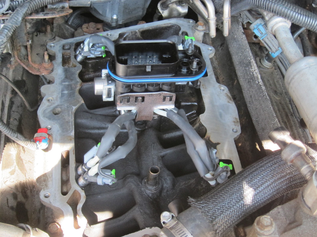

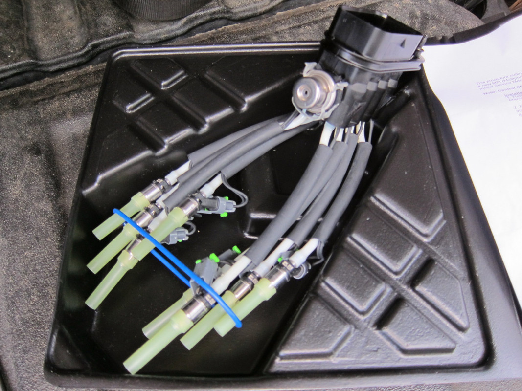

That spider assembly is a notorious leaker. One of the worst injection systems GM ever came up with. If you're not seeing  and smelling fuel externally,  it's either a bad regulator or an injector or more hosing down the bottom of the intake manifold. They always crack and spray fuel - sometimes causing a misfire, sometimes not.
I can't remember if that era had the capability to do an injector balance test with a good scan tool - that would be where I'd start. If not, time to start digging to get that intake manifold off.
If it's never been changed, it's the old style as pictured in the last 3 pics. The new style has actual injectors right at the ends of the spider legs, instead of the failure prone poppet valves. Probably wouldn't hurt to upgrade anyway if it hasn't been done already. If you see any clean spots in the lower intake manifold, that's a dead ringer for a leaker. This particular vehicle here got one just as preventative maintenance, since thousands had been spend in getting her running back in 2014. The first 2 pics are of the updated spider, last 3 of the OE spider on a '96 Tahoe 5.7:
