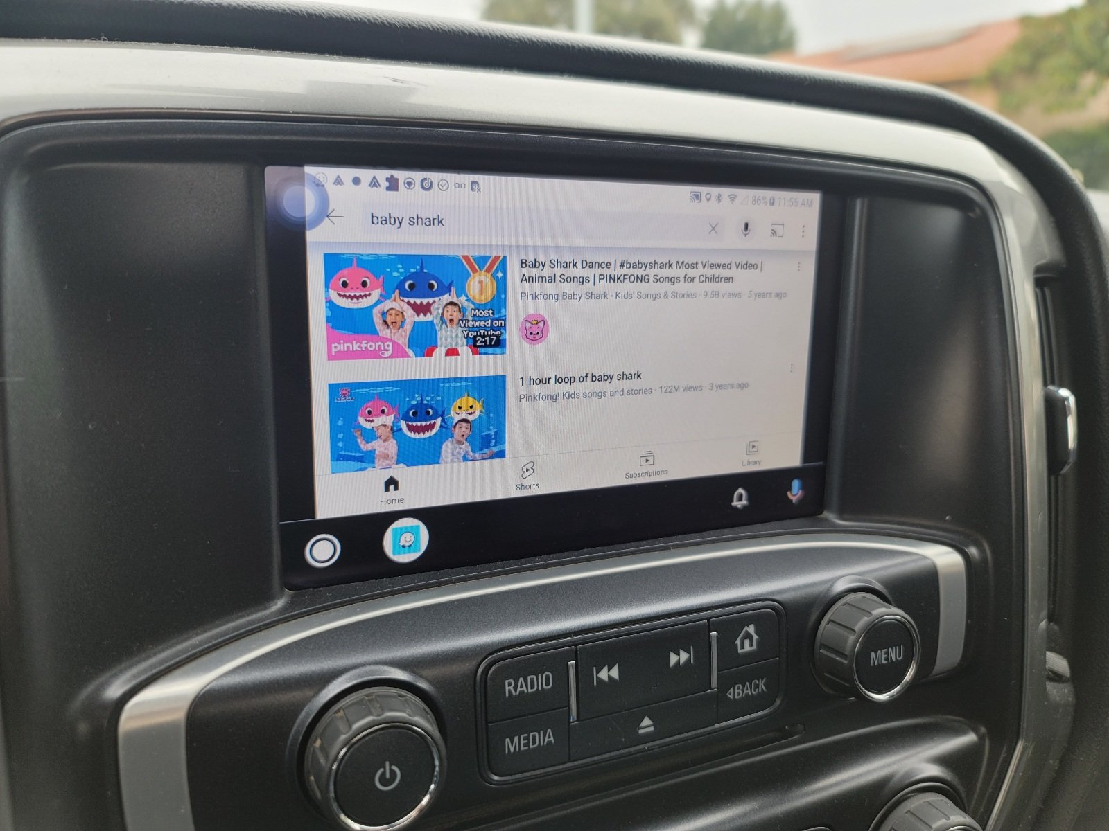

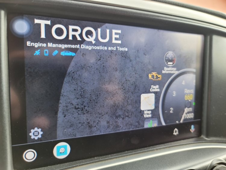

Android Auto - Screen Mirroring - non rooted and rooted
- Spare phone needs to be rooted, I used Magisk
- install Android Auto from Play store. Tab on Version 10 times to enable developer mode. Under developer setting, change to developer and enable unknown source
- install Screen2auto found on xda. Launch the app, click setting and unlock, grant root access
You are golden!
I plan on installing my new dashcam and use the rear camera behind the front grill as a park assist.
For internet access. I connects the spare to my main phone hotspot. I have 40gb of hotspot so I'm putting it to good use.
