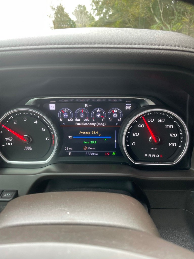

1 hour ago, WeGone said:
My 2021 6.2 has used 1qt in 3300 miles total mile on it now. I did my first change was at 1500. I always run in 9th gear around town (so no cylinder de-activation) and only go to 10th on the highway over 65mph.
