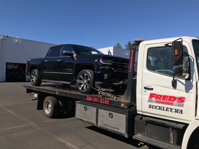

Pic was getting towed to shop on 7/22/21 with blown engine.

That is not a great feeling, will share my 16 on a flatbed with an expired 6.2 at 23000 miles.
