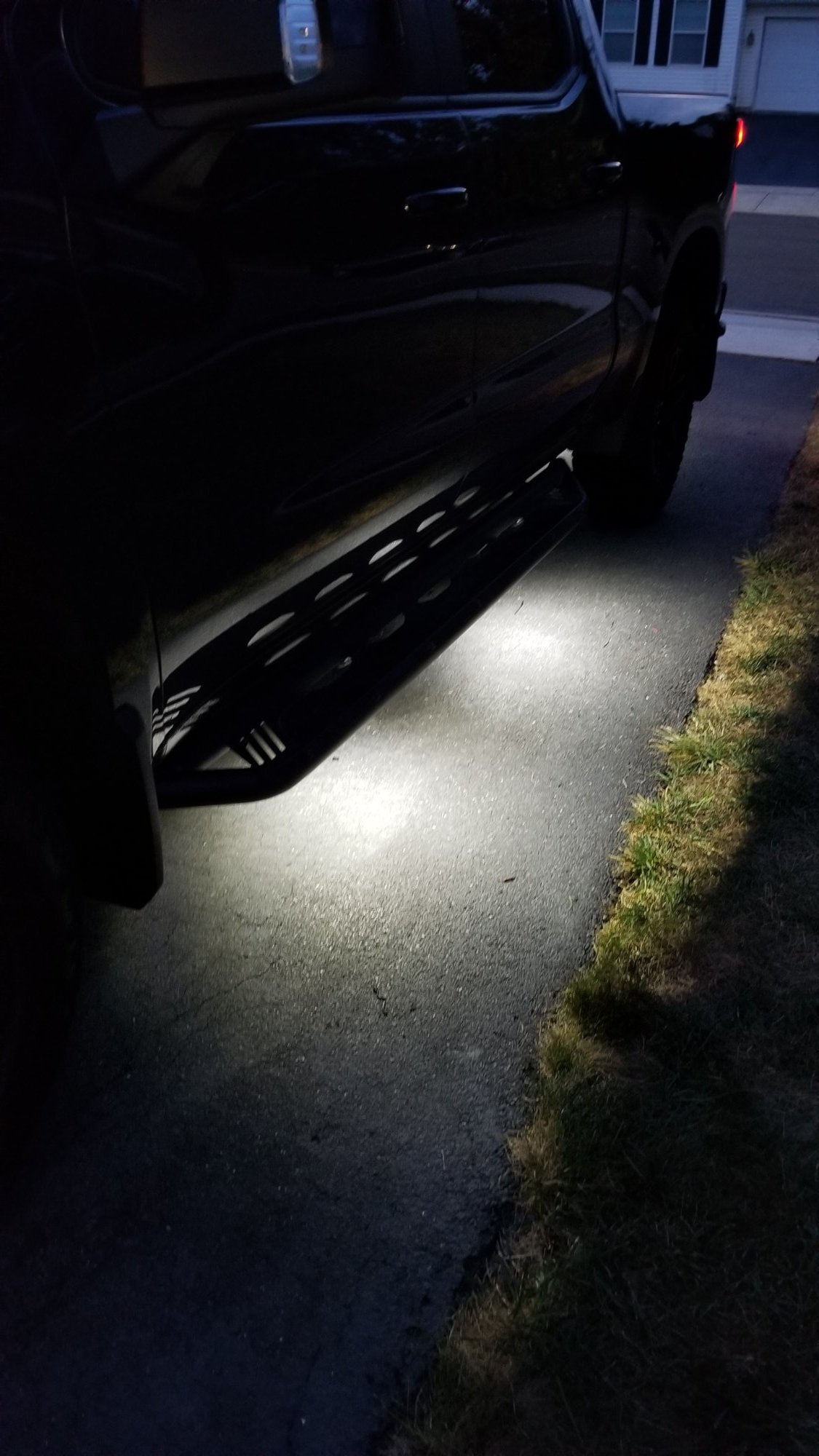

Not quite what you want but I added rock lights on the sides mainly for entry lighting. Might be an option if the mirror thing turns into a bigger project than expected. Adding rock lights requires some work too though.
