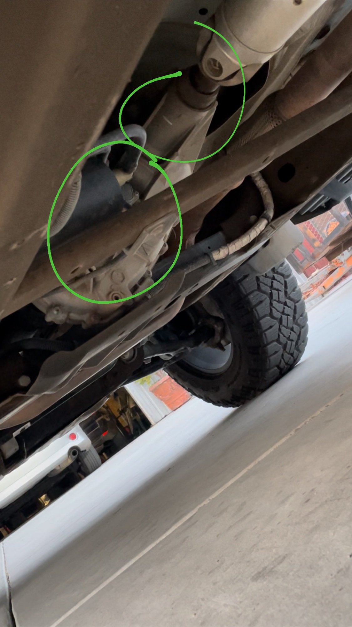

I was wondering if it’s normal for 2019+ Silverado 8l90’s to have a clunk/bang  going in to reverse from park and also from any gear to reverse for that matter
I saw the drive shaft that connects to the transfer case when testing and it moves shakes violently when I go reverse only.
Truck has almost 60k miles. And has had the atf changed.  Always thought this was normal. Until my inlaw said wth is  wrong with your truck.
my in laws 6 speed older Escalade doesn’t do this all at always shift like butter going into reverse.
could it be a characteristic of the 8l90’s?
I attached a photo of the shaft that shakes like crazy and the transfer case. Only when I go into reverse.  Has done this since brand new. Just always thought it was normal.  Maybe the transfer case is loose or idk. Worried this tranny can go after warranty. If this isn’t normal and the dealer says it’s normal might potentially trade in.

My 2019 8 speed.  does the exact thing. Only in reverse it slams into gear.  After I drive it a few miles it doesn’t do it. You can let it sit and warm up all you want but that doesn’t help, it has to be driven a while for it not to fo it. I’ve gotten in the habit of backing in to the garage or parking spot after driving so it doesn’t do it, that way after it cools down I can pull out in forward to avoid the hard clunk. Carried it to the dealer a while back but of course when I get here it was warm from the drive and didn’t do it. Of course they said it was normal. It can’t be good  for the trans, this isn’t your normal jerk, it’s a hard clunk like gears slamming together, shakes the whole truck.  As far as driving, it shifts smooth. No problems there.

Thanks for the reply. Yup so we seem to have the same issue. Expect yours doesn’t do it anymore when you drive it a few miles at least.  I think yours sounds like the “delayed engagement”
Because that issues explains that it only does it on the initial reverse then goes away…. And comes back if left overnight etc…probably a good idea to leave it at the dealer over night so they can see the issue on a cold start.
In my case The only time mine doesn’t clunk/slam is on a cold start when the RPMS are over 500 if I shift to reverse quickly it won’t do it at all. everything is quite. Once the normal idle of 500 comes in it’ll clunk 24/7 all day everyday into reverse smh.
And yes when it’s slams it feels like something drops hard down underneath you… one solid loud bang. it can’t be good but I don’t get why some 8l90 are smooth as hell. Must be a software issue. Or idk my transfer case because all that moves and shakes hard on the clunk…   it shifts just fine other then that.

So anybody have this jolt/clunk/bang with a small delay  going into reverse?  Along with a rattle on their drivetrain near the transfer case.. . Or does your 8l90 shift like butter going into reverse??? With no noise from underneath.  Is it supposed to?….
  I did try it in 4lo and 4hi and the clunk is actually a lot less going into reverse not sure how.
if you had this issue what was the fix?  It happens every single time I go into reverse unless the RPMS are high on a cold start the drivetrain feels tight. Then at idle it gets sloppy again.
my in laws 6l80  shifts in to reverse like butter you don’t feel any noise or delay or movement in the drivetrain.
