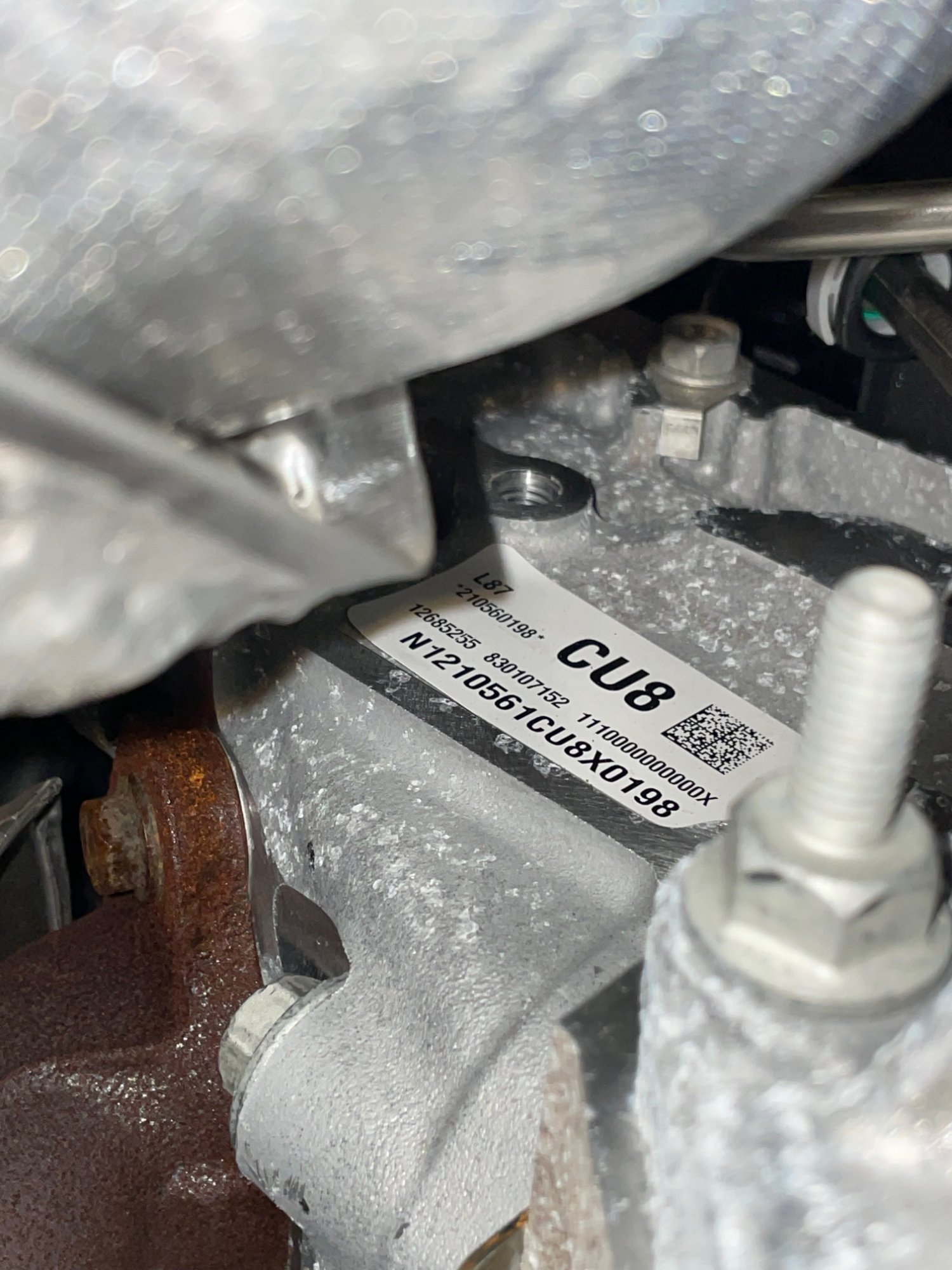

Question on the bad batch of lifters. Are the Sept 2020 to March 2021 engine dates or vehicle completion dates?
Lifter production dates.  GM had to special return lifters in stock in the date code range, they had a special return on crate engines and VLOM kits as well.
So if you had a build date of 3/21/21 you would be in the (bad lifter range)I would guess the motor was built at least a few weeks+  before build date?
Update:  So my engine build date is Feb 25 21
Edited by WeGone
Julian date range was 20245 to 21063.  So September 1st 2020 to March 4th 2021.  This is the exact target range of possible defective lifters produced in the parts network, part kits, engines.
Edited by newdude
