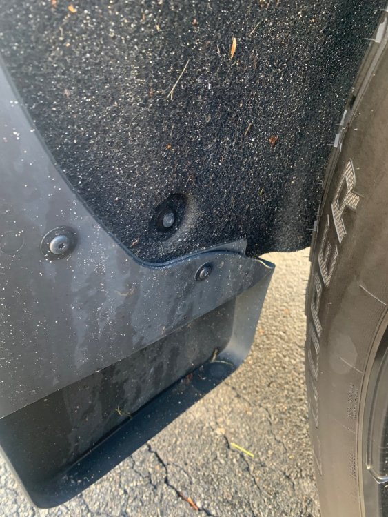

I just went through having to clean where my negative cable bolts to the frame. Passenger side wheel well. You can see it and clean it without removing the fender well.
the other part grounds above the starter. You do need to pull the fender liner to see it.

I told you what to do. The battery negative cable runs down the firewall to two places. One is above the starter on the engine block. The other is the passenger front tire on the cab side of the frame. Make sure these are clean of frame wax and rust. Mine had some insulation near the terminal between the metal and the frame. It’s a 10mm bolt. You can’t miss it. You do not need to remove the fender liner. You can take a few torx out to make it easier.
