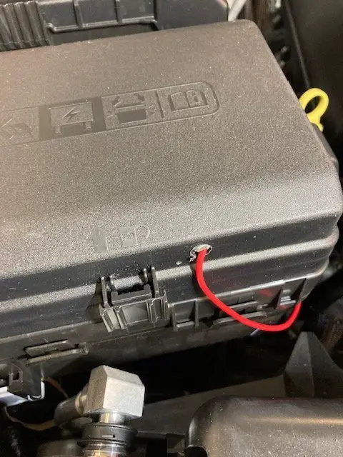

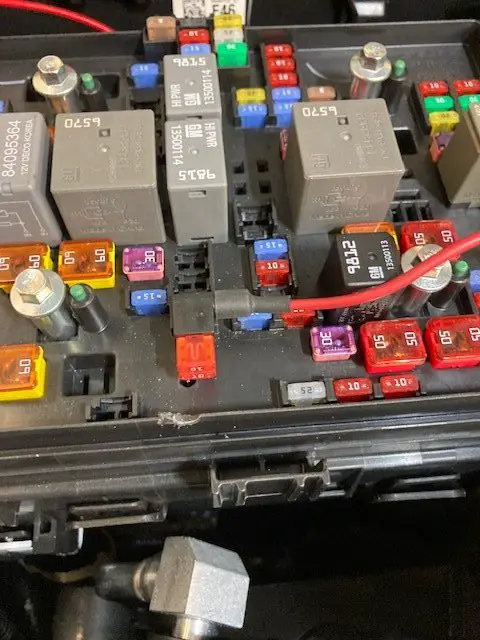

Here is what I did to power a front camera on my 2020 Custom.

Tap into the headlight fuse, this fuse receives power when the truck it on, it does not turn on the headlight. I have had no issues no errors.
