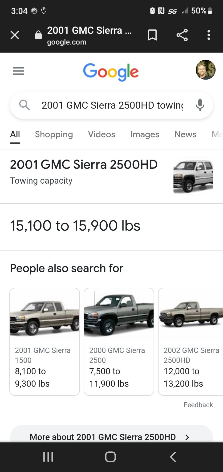

Nice to see you are so well informed.

He isn't wrong though, you are well above the factory rated towing capacity of a 6.0/4L80e truck.
This is from the owners manual.
Quote
C- 2500 Crew Cab Short Box HD (2WD)*
Engine Axle
Ratio
Max. Trailer Wt.
6000 V8 4.10 10,300 lbs. (4 672 kg)
8100 V8 3.73 13,600 lbs. (6 169 kg)**
4.10 15,600 lbs. (7 076 kg)**
6600 V8 Diesel 3.73 15,500 lbs. (7 031 kg)**
4.10 15,500 lbs. (7 031 kg)**
You didn't do the most basic research on what your truck can tow, and you come across as someone who just doesn't care.
Most likely, it will take either having your vacation ruined by being forced to at least rent a more capable truck midway through to be able to continue your journey, as well as pay a hefty fine, or an accident with a court date for you to consider getting a vehicle capable of towing that trailer safely.
Google is just not trustworthy. CamGTP showed you the owner's manual data, so go with that. I have an '03 GMC 2500HD 6.0 4l80e and wouldn't consider towing more than 8000 lbs. My trailer is 7000 lbs fully loaded and the truck bed is full of stuff. The truck labors a bit, even in Tow mode, but at least I'm safely within the truck and trailer's limits.
