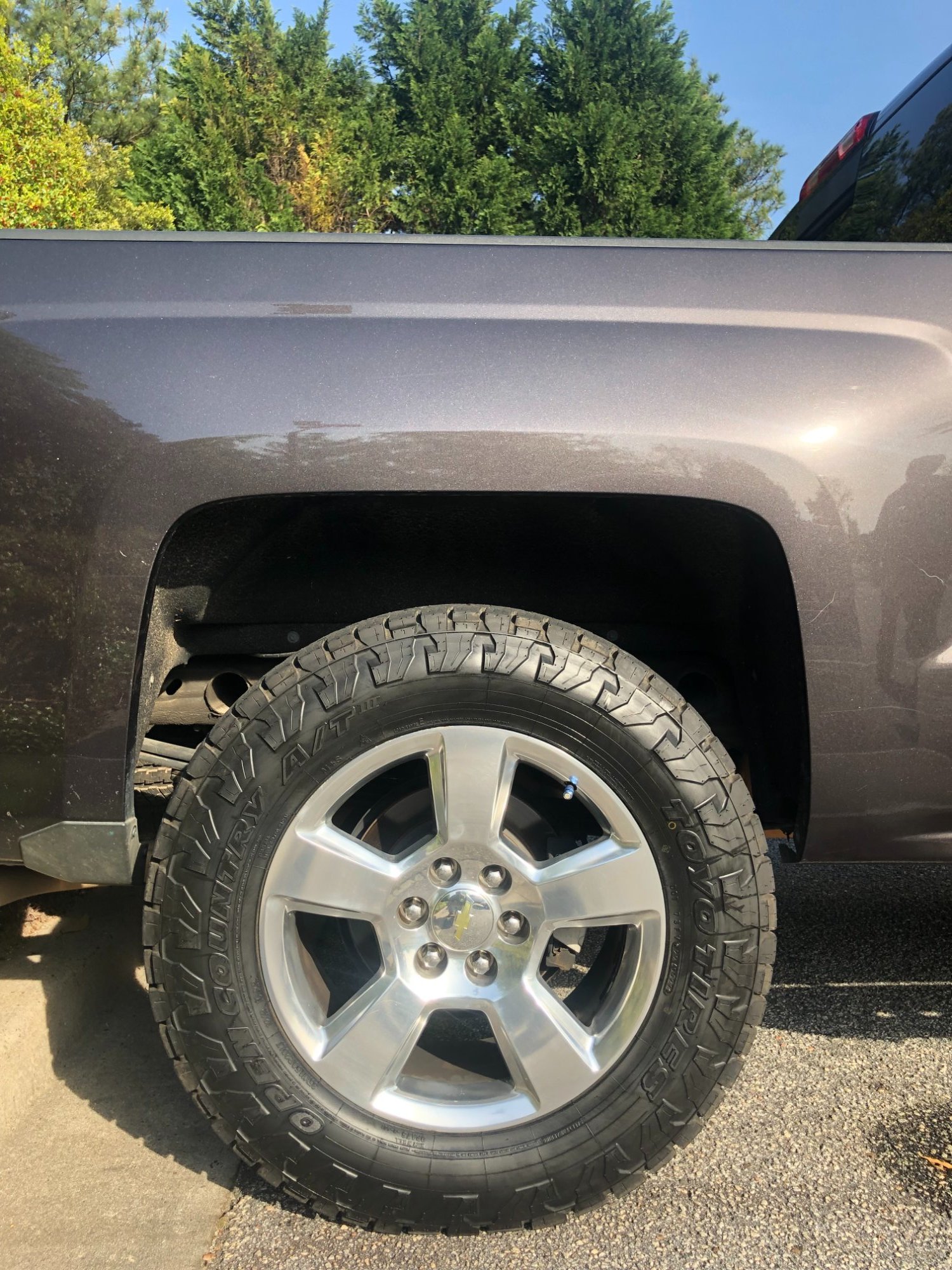

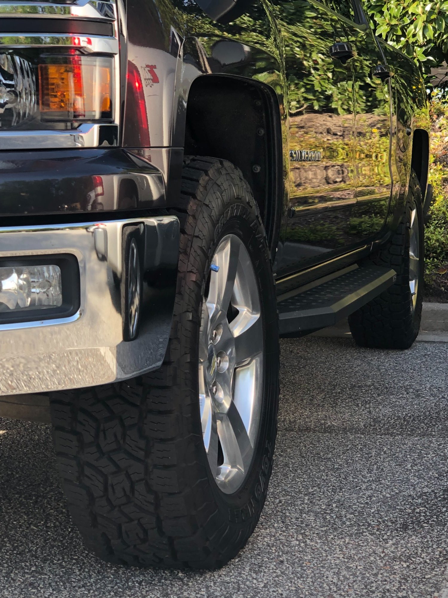

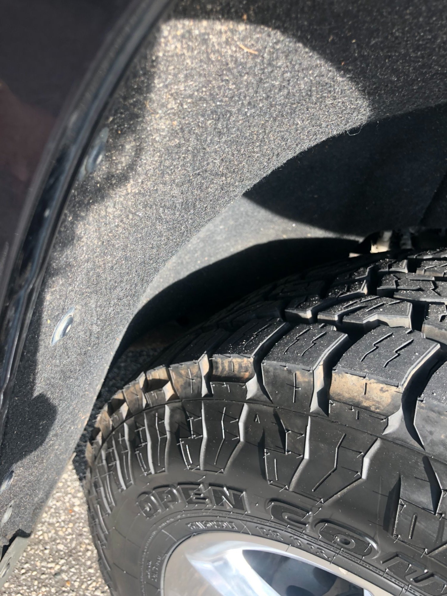

This was when I first got the truck.  35in tire on the stock 20in wheel.  Truck was only leveled.  It did rub on full turns.  It didn't stop rubbing fully until I lifted the truck and did a off road bumper.  My Fuel wheels rubbed a bit until all that was done.
