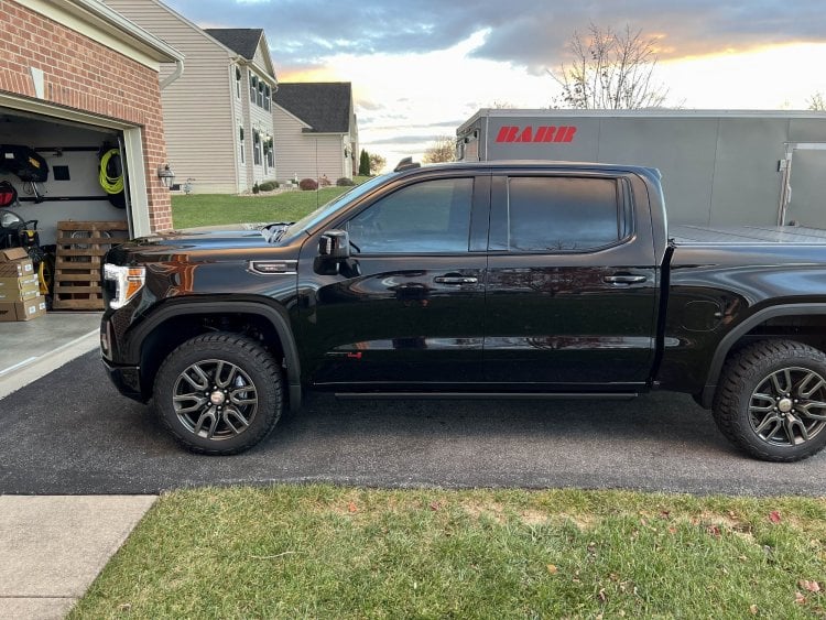

And not to hijack this thread, but for any potential questions from others regarding the 35" tire fitment I mentioned, below are the specific wheels, tires, etc., I went with.  In my case, an approximately 2" wider tire (10.4" OEM to 12.5" BF Goodrich) with 1" less offset/backspacing in the wheel put the inner tread of the new tire in approximately the same position as the stock tire.  The additional width to the outside (now 2" with the offset change) was covered by aftermarket fender flares (from EGR, in my case; painted to match).  Finally, I'm using one of those Hypertech plug-in speedometer calibrator modules (730129T) to correct the speedometer.  I've had zero issues with it, so far.
OEM tires (spec height 32.5", spec width 10.4") 20" LT 265/60 R20
OEM wheel weight, complete assembly, minus lug nuts (actually weighed):  84 lbs.
Aftermarket wheels:
Fuel Siege Model D706 Matte Black  20x9
Size     BP         Part Number     Finish         Bore     Offset     backspace (in)
20x9     6x139.7     D70620908450     MATTE BLACK     106.10     +1mm     5.040
Tires:
BF Goodrich All-Terrain T/A KO2 - Size: 35X12.5R20LT  weight: 67 lbs.
New tire/wheel combo weight, from specs:  102 lbs.
OEM weight:  84 lbs.
Difference:  18 lbs.
GMC no-drill fender Flares:
https://egrusa.com/EGR_Product_Pages/791794.php
-Can be painted to match.
-Black bolts available from EGR directly (call; $20)
Hypertech 730129T
https://www.summitracing.com/parts/HYP-730129T
Programmed Scale factor I settled on after testing against GPS = 1.059
BEFORE/STOCK:
AFTER ( includes 4" Pro-Comp lift kit K1176B )

That's one of the best looking AT4's I've seen.  Clean and sleek.  What do you think you have invested in the aftermarket stuff (wheels, tires, lift, flares+paint, ?)?

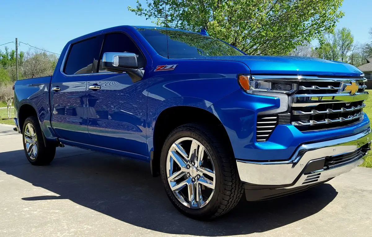

It's not so much the offset that matters on the T1; it's the angle of the spokes to clear the calipers.  I went with the 22X9 TB wheels on my '22 refresh.
Edited by mafd2
Thanks.
Oh man.  I'm not sure if I want to add it all up.  Probably 6 or 7 grand after everything.  I do still have the complete OEM wheels/tires to sell (with about 300 miles total on them), so I can recoup a little bit of it there (if I ever get around to selling them).
- Pro-Comp 4" Lift Kit was right at $2k
- Lift kit install was around $1500
I had the lift kit installed by a commercial customizing place near me that's done a bunch of them on these trucks.  That price included everything (new wheels/tires installed, having a dealership paint the flares to match, getting it aligned at a quality shop after install, etc.)
- Fuel Siege wheels were $1600
- BF Goodrich 35x12.5R20 K02 tires were $1600 (4Wheelparts.com had a $100 discount on a set)
Not immediately noticeable (but contributing quite a bit to the overall look, I think) are the AMP retractable running boards.  Definitely overpriced, imo, though I did get them to knock 200 off due to shipping delays that ended up being well beyond what they told me when I ordered.  They ARE very nice, though.  Well thought out, straightforward install, flawless operation, so far.  Anyone considering should do themselves a favor and NOT order the AMP-branded OBD-II pass-through if they want to keep their OBD-II port accessible, though.  Pick up the one from Auto Meter for less than half the price instead (part 5323, it's on Amazon for around $35).  Bonus, that one actually bolts right into the original location, so your OBD-II port looks and functions exactly as it was before install.
- AMP PowerStep Xtreme running boards $1800
Latest addition is a set of Air Lift helper air bags (89388) and wirelessly-controlled on-board compressor (25980EZ).  The lift kit levels out the factory raised rear end of the truck, which is a much nicer look on a lifted truck, imo.  But adding any significant weight to the rear (like that 7k GVW trailer sitting behind it) can potentially introduce some squat.  The compressor has user-defined pressure presets for known loads (like a trailer).  They run empty under normal conditions (5psi, just enough to keep their shape) and a touch of a button (or app control) pumps them up whenever I'm towing the trailer.
Edited by barr8888
Are those factory 22" wheels or replicas?  I ask with not knowing for sure if they even offer a factory 22" version of that wheel.  If replicas, do you know the backspacing, maker, tire size, etc?  I've had such a hard time even finding anyone with a 19+ truck with these it's incredible.  Good looking Chebby
Thanks.  These are TB replica wheels with a +24 offset.  Great quality and beautiful chrome.  They balanced out perfect with no vibration. Tires are Firestone Destination all terrain A/T2 285/45/22.  Ride extremely smooth and are super quiet.  Firestone is using more silica in the compound on these tires.  Good luck man.
Edited by mafd2
Thanks for the wheel info, can you send me a link to where you bought the wheels from and P/N?  Several people make them, need to make sure I get ones that'll clear the calipers.
Sent.
