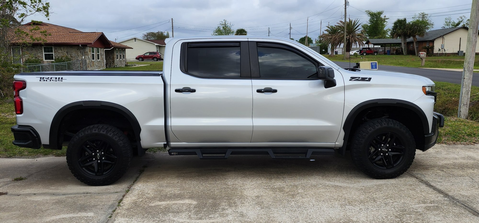

Does anyone have the 84297538 GM fender flares for 19-21 Silverado?

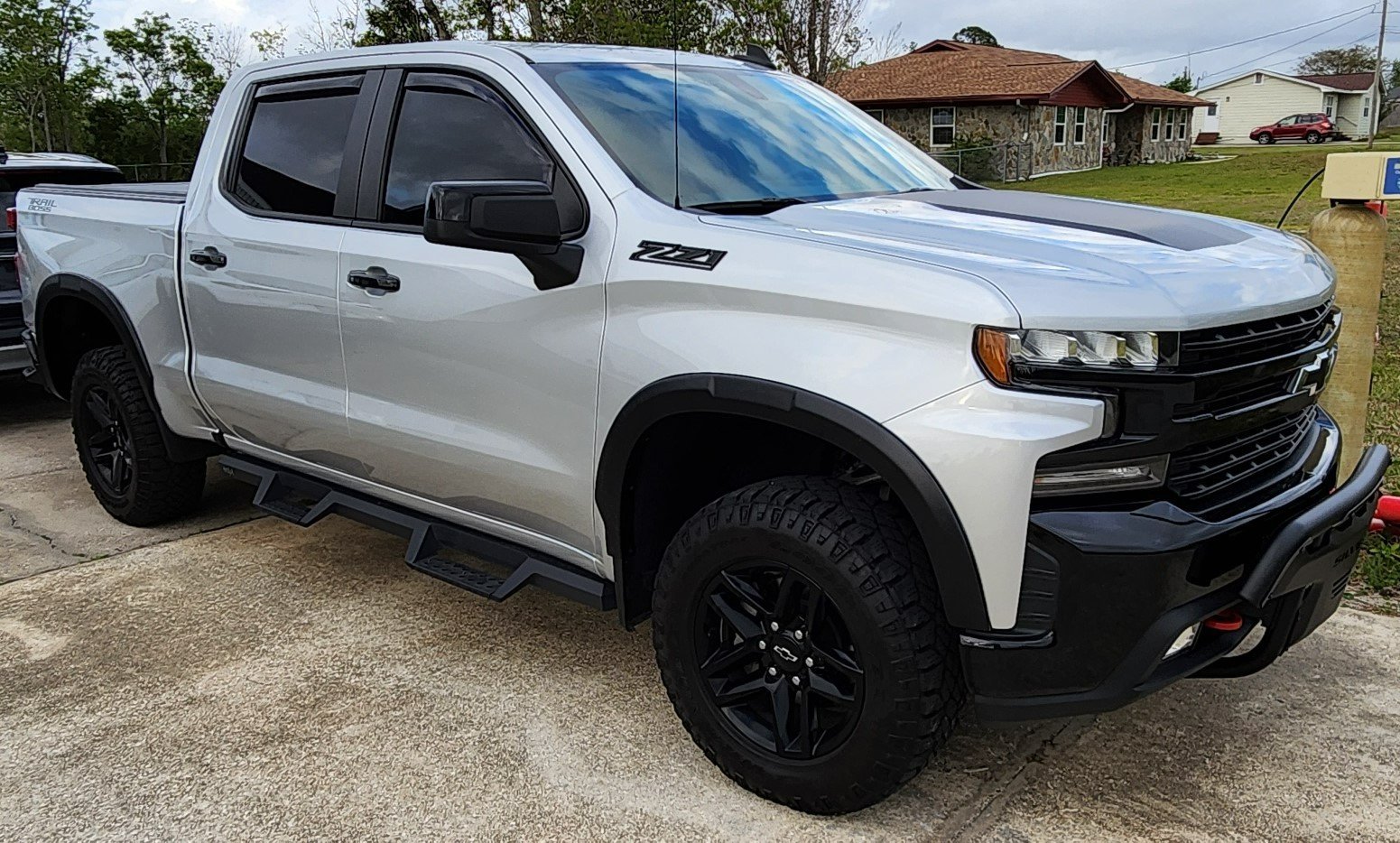

Those look really good. Way to figure it out for us lol. Just one question, when the fender touches the paint, does it allow the fender to move and flex from vibrations? Wondering if dirt and grit can get in and damage the paint.
I put Rough Country flares on my truck and they came with rubber edging to go against the edge of the flare and the body. I could kind of see that on the rear ones here. I bought some clear paint protector tape that's 1/2" wide. I bought a grease pen and mounted the flare without the edging to determine where they would sit. I then traced the outside edge of the flare on the body. I put the protector tape on the inside edge of the line. I put the edging on the flare then mounted them.
These come with rubber edging you put on, they also come with pieces you put on the paint where the clips slide onto the painted part under the flares. They are held on pretty tight so not a lot of flex.

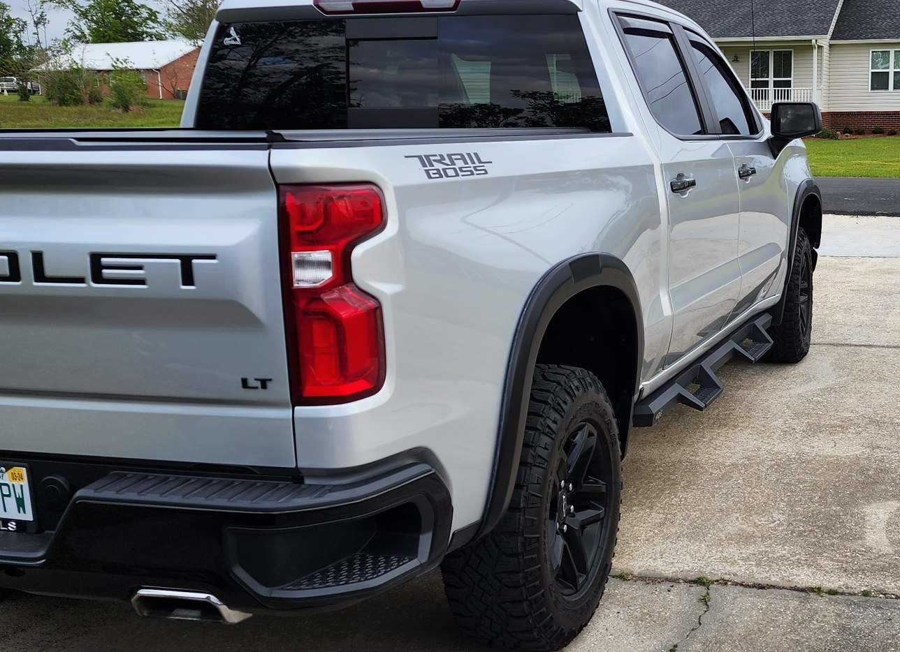

I pulled the trigger on these flares on eBay.  $300 shipped.  I was not crazy about how smooth they were out of the box, was expecting a bit more texture.  But once I got them on I loved the way they looked.  No instructions provided but the install was fairly easy,  I looked at some instructions for similar style flares from other brands before starting out.  The fit and finish is perfect, all the hole and edges are lined up right where they should be.
I'm a fan...Not too big, not too little.

I forgot to show the front flare and how it mounts around the front air slot.  I thought it was pretty neat that it retained the opening and did not cover it up which I thought for sure it would have.
