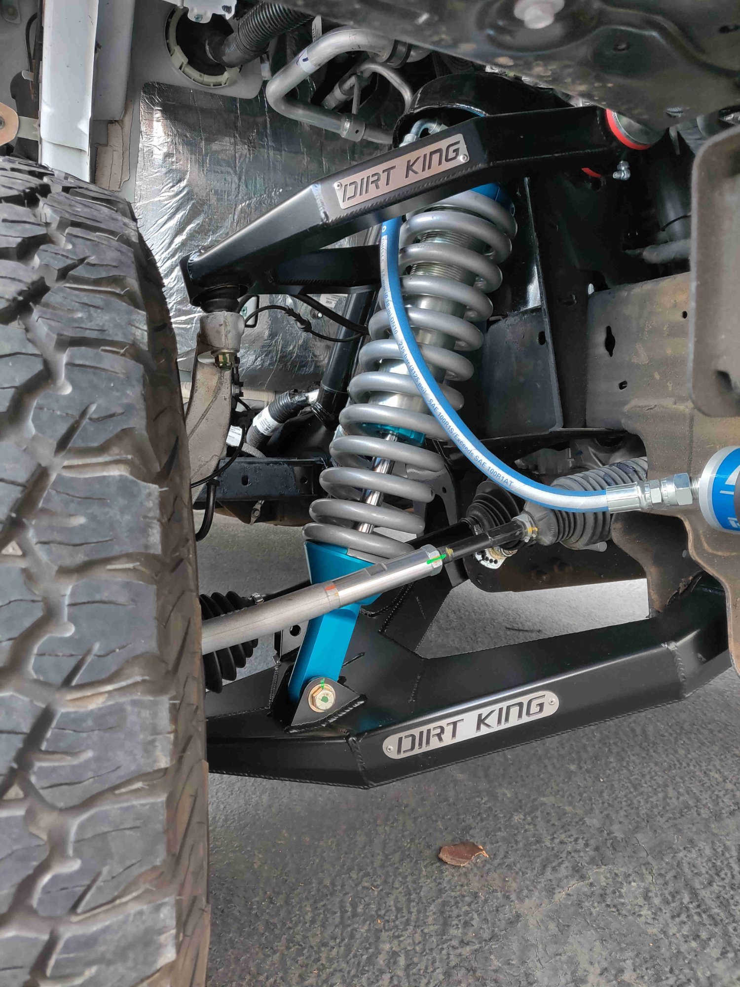

I have a 2020 Sierra 1500. 4x4 SLE trim, came with the X31 package. Was originally going to go with OE replacement King shocks front and rear with an aftermarket upper control arm. After purchasing the shocks, about 5 months into waiting for them I decided to just bite the bullet and go for a full front kit, fiberglass, etc.
Choosing parts:
At the time the two kits on the market were from Dirt King and Baja Kits. Everyone I know in the industry says to avoid Baja Kits. They are poorly designed and poorly made. I've heard a number of people have issues with their products. So far Dirt King has been great; their parts are high quality and its always easy to get ahold of them. Here is a short YouTube video that highlights the key differences between the quality of kits. YouTube Video. Mazzulla also offers a kit now and they are known for the quality of parts. The downside is no bypass shock mount and using an OE replacement shock which affects motion ratio which requires you to use a higher spring rate and heavier valving. This in turn makes tuning a little more difficult. At this point I'd recommend Dirt King>Mazzulla>OE Replacement>Baja Kits.
I went with King shocks purely because I've always been a fan. Fox and ADS both have similar products, you can't really go wrong with any of them. The pro for Fox and King is that everyone services them and getting replacement parts is easy. ADS is a smaller company so it can be a little more difficult finding someone that has spare parts readily available to service them.
Fiberwerx and ADV are the two manufacturers with fiberglass on the market right now. Something to keep in mind is that no matter what you read, fiberglass is never just a bolt on application. It requires a significant amount of work to get it to fit properly.

Already have deavers, bypasses, Dirt King shackles, and bedcage. Just need to install them on my next free weekend. Will be dropping the truck off in a couple weeks to get the frame rails cut back and a bumper made. Just ordered 6 Baja Designs XL80s to go onto the bumper. Eventually a high clearance rear bumper and paint for the fiberglass. Then it should be "done" and I'll be able to move onto my next project.
Here are some pictures of the truck, from the first weekend with it, stuffing 34x11.5 on stock suspension, first trip with the long travel kit, and finally with 37s.

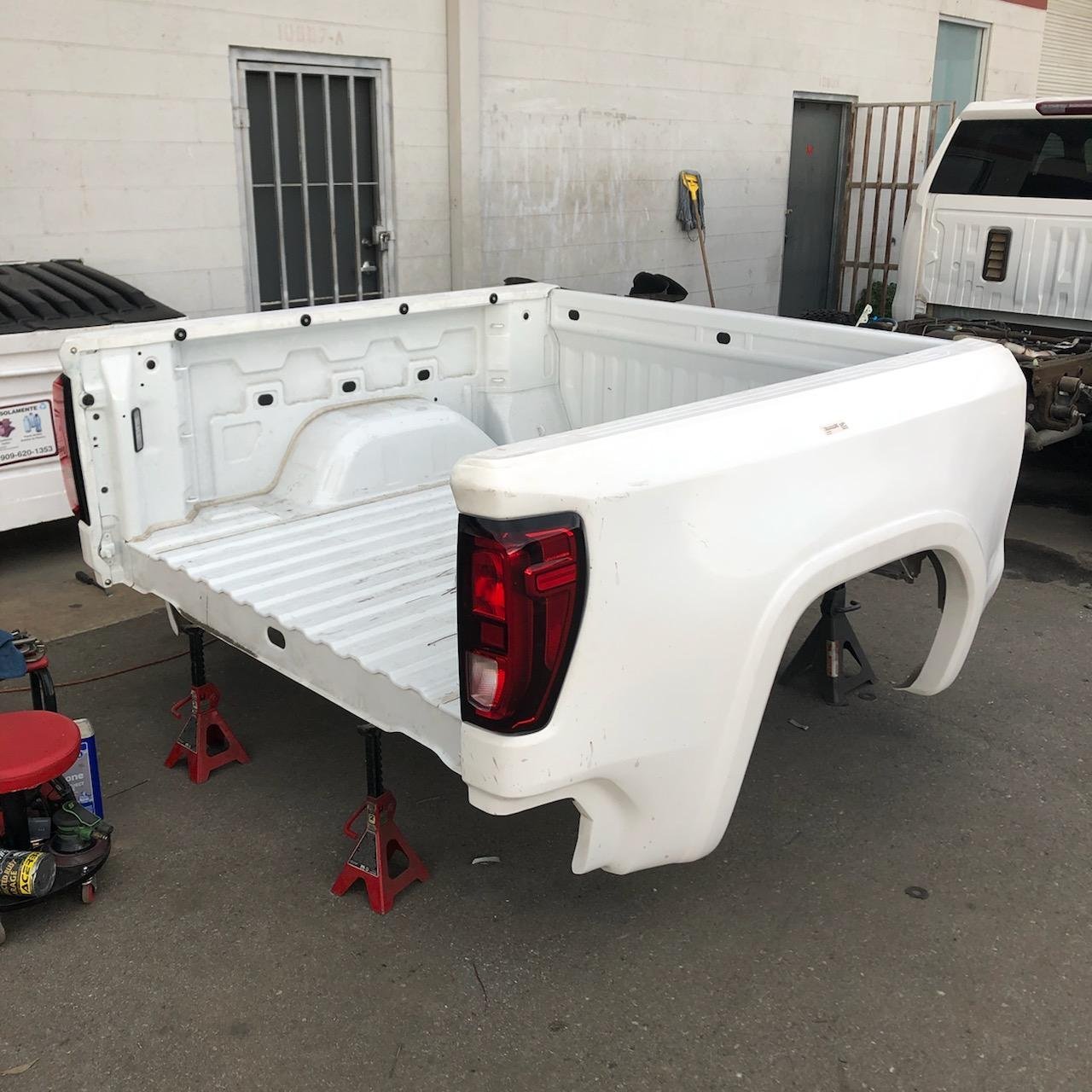

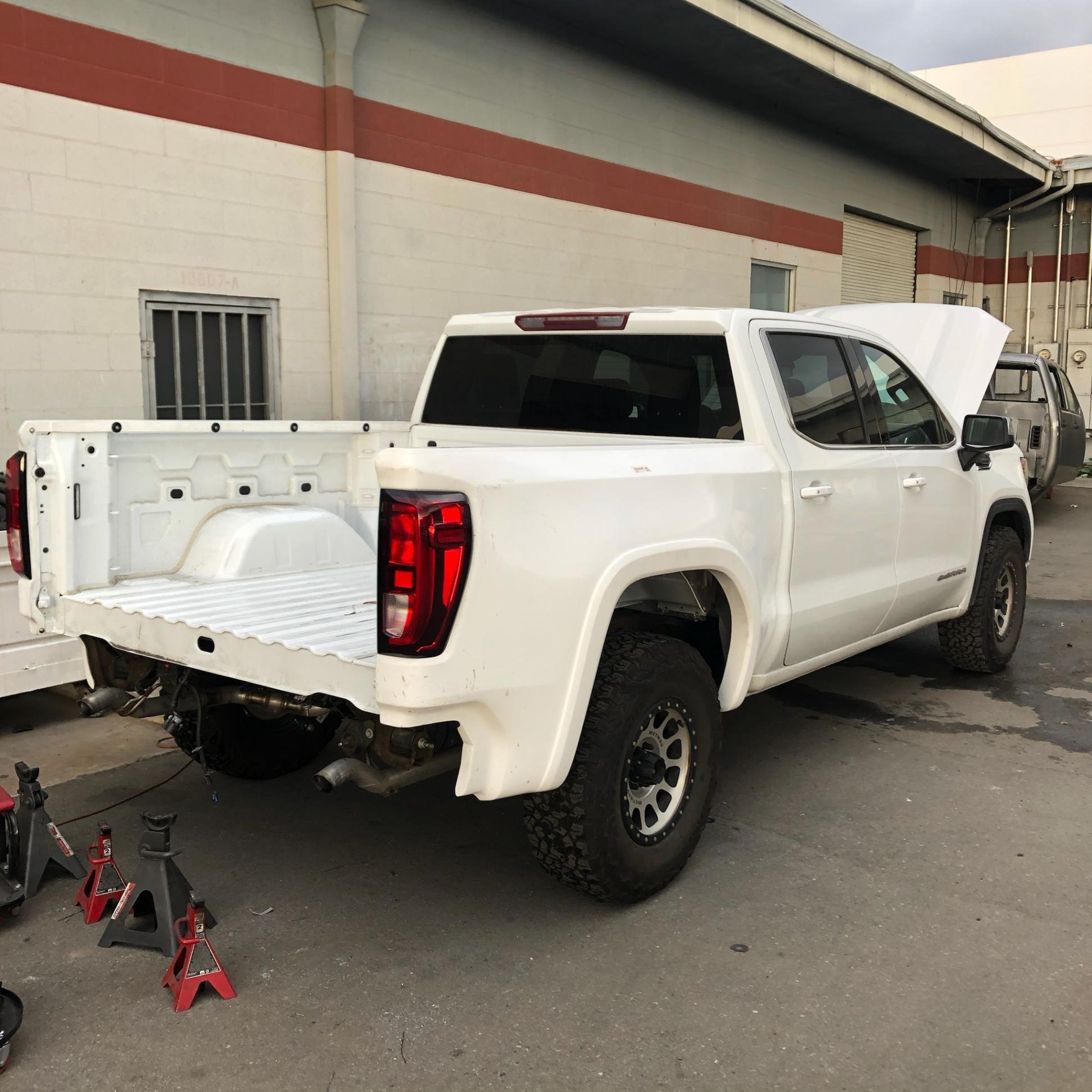

Just some pictures from when the fiberglass was getting installed. Bedsides require cutting the bed apart, front fenders just need to be unbolted. Fiberglass installation can be expensive. I paid around $1500 and there are definitely some uneven panel gaps. My buddy just paid $7000 to have fiberglass installed on his Tundra and painted by an actual composite shop and his is a lot closer to factory quality. It also took 3 and a half weeks vs 3 days. So unless you really shell out some cash, be prepared to accept the fact that it won't fit up as nice as factory. But unless someone is really looking closely, most people won't see much of a difference.IMG_20210308_194913.thumb.jpg.af8a2c29e91cbff43129ac0a25c0bff3.jpgIMG_20210308_194915.thumb.jpg.b0f2bbdf1613f546c069af7bcfeab733.jpg
  • Thanks 2

Never ran without fiberglass, would probably have issues with tires crashing into the fenders. Don't need the oversized inner fenders on the new trucks, 37s clear with the stock ones. I'm probably going to get some ABS to create some splash guards to keep the engine bay a little cleaner.

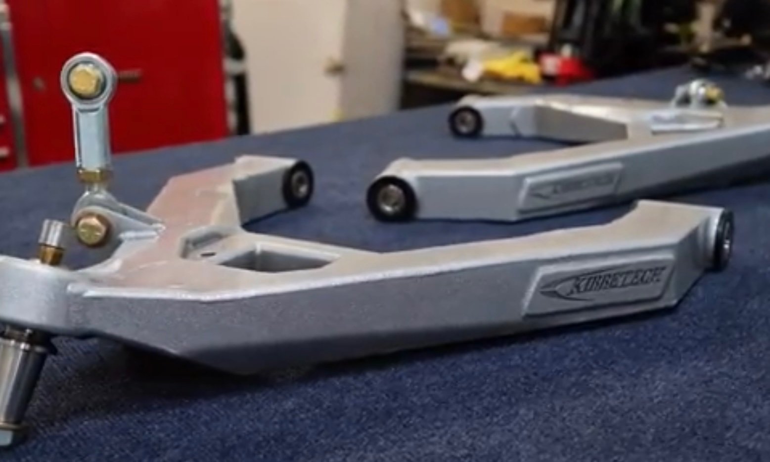

Kibbetech just made, from what it sounds like, stock length lower arms to pair with their billet uppers. Didn’t look like it was bypass capable but the video mentioned it was their first prototype for 2/4wd. Soon to be online for purchase I guess.

Yeah they'll fit an OEM replacement coilover and retain the sway bar. Will be a good option if you want something stronger than stock, but don't want to drop thousands more into a full kit. Still looking for someone to make a 4wd capable aftermarket spindle. That'll definitely be the weak point.

Any chance we can gusset them? Are they cast steel?

I believe they are cast steel so you should be able to weld a gusset. I've thought of that, but have never gotten around to checking clearances and what would be able to fit. I know Toyota guys have to do it since their spindles are even thinner.
