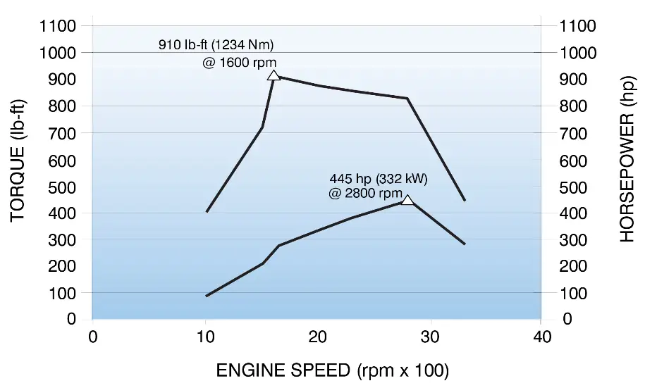

L5P
LT8

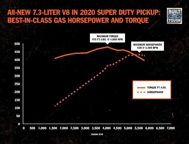

2 hours ago, redwngr said:
LT8
Thanks for posting this chart. :thumbs:
Now I see why GM chose the transmission programming they did.  Pulling heavy feels just like this chart.
Compared to the Ford 7.3L it's easy to see why the Ford tows heavy much better than the Chevy.
That wrote, the 7.3L requires 93 octane to tow, and gets less fuel mileage.
Next time I'm doing 45mph up a steep climb to keep the engine from rev'ing it's guts out, I'll have to remember that, and smile a little bigger. 😊
93 is NOT required to tow. They just say it's recommended for best performance to prevent knocking/pinging. If you are towing and not having that issue, no reason to run 93.
Sounds like you haven't tried running 87 Octane while pulling heavy with the Ford 7.3L.   It pulls out power and sounds terrible, on long grades.

I've pulled from the coastal mountains up through the Rockies.  But the Ford experience was pulling a cattle trailer (a bit over 15k lbs) from just under 5k'asl up over 7k' asl, and back to about 5k'asl in Utah.  Temp ranged from high 70s F to mid 80s.
Screwed up and put in 87 octane.  Truck did not like it one bit.  Told my buddy what I did to his truck, and he just laughed. He'd done the same thing on purpose with the same results.
It also got real bad fuel mileage on that pull.  Somewhere around 5mpg.
I thought I'd damaged his truck, but I refilled with 93 and it was OK.
Won't make that mistake again.
He's pulled heavier, but now only uses 93 octane, except in the dead cold of winter when he drops to 89 for better cold starting at altitude.
