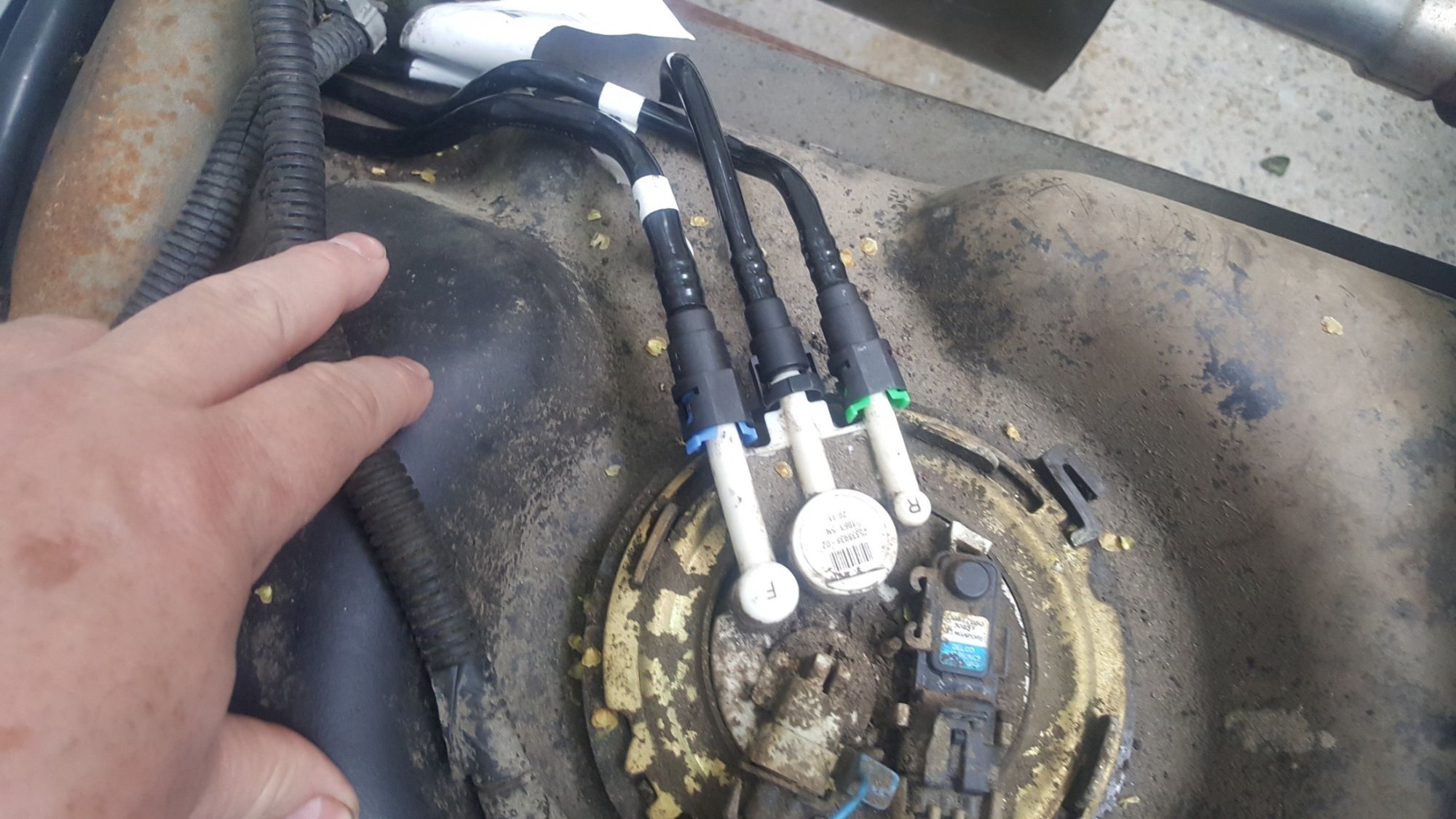

I got the 3rd fuel line needed yesterday.  When I got home I got all 3 installed.  I had pulled the fuel relay and tried to crank it just to try to use all of the fuel in the lines.  There was still a shot of fuel in the return line and I got an earful of it.  :D  Better than an eyeful.
I got all 3 lines installed last night.  I cranked the truck, on the second attemp it fired right up, checking around, there were zero leaks!
I just have to figure out how to connect to the evap nipple.  I was thinking I would hose clamp a short piece of fuel line onto the broken nipple, then run a fitting with a barb end on the other end of the fuel line, and hose clamp that as well.  The other end of the plastic fitting would have the gm style shoulder for that quick connect to latch onto.  This is just vapor, it's not running fuel, it should be ok.  Any suggestions?
3 NEW FUEL LINES (I think the corrugation on the wire harness I'm holding back may have rubbed on the line that was leaking).

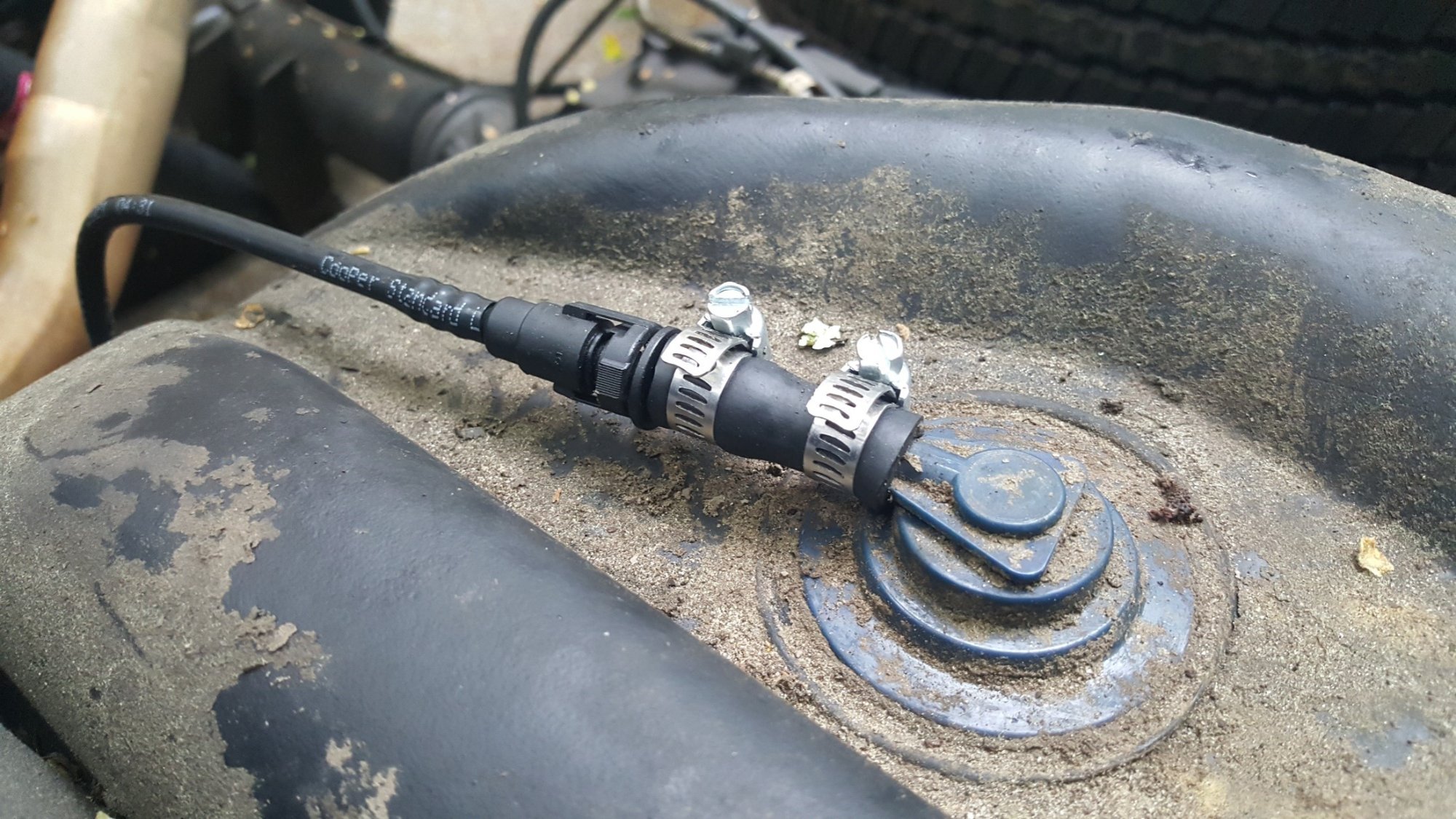

NEW EVAP LINE NEEDING CONNECTION (this is the only thing left then the bed goes back on).
One of these barbed fittings with the shoulder (the quick connects that ship with these will be trashed), attached to a hose attached to the broken nipple.
Edited by 7milesout
Here's my solution to the attachment to that nipple.  With that, the bed is ready to go back on, as soon as I can borrow the manpower.  And I think I want to try to find a way to hold that corrugate-covered wire harness off the fuel lines.
