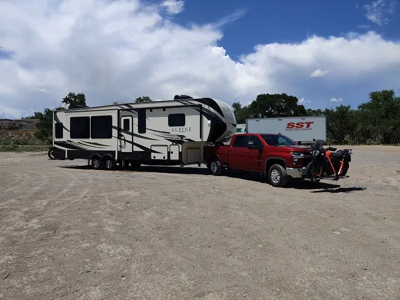

I tow just under 30% of the time, with weight between 14,300 lbs and 15K lbs (better than 98% of the time is a good sized 5th wheel travel trailer, but I've pulled a cattle trailer a few times as well) with a gas 3500HD.
Certainly the gas engine is a weak dog compared to the diesel, but I really only miss the diesel when pulling long steep grades, and when navigating gas stations while towing.  Gas pump islands are rarely designed for long trailers.
Good luck on your choice. :cheers:
