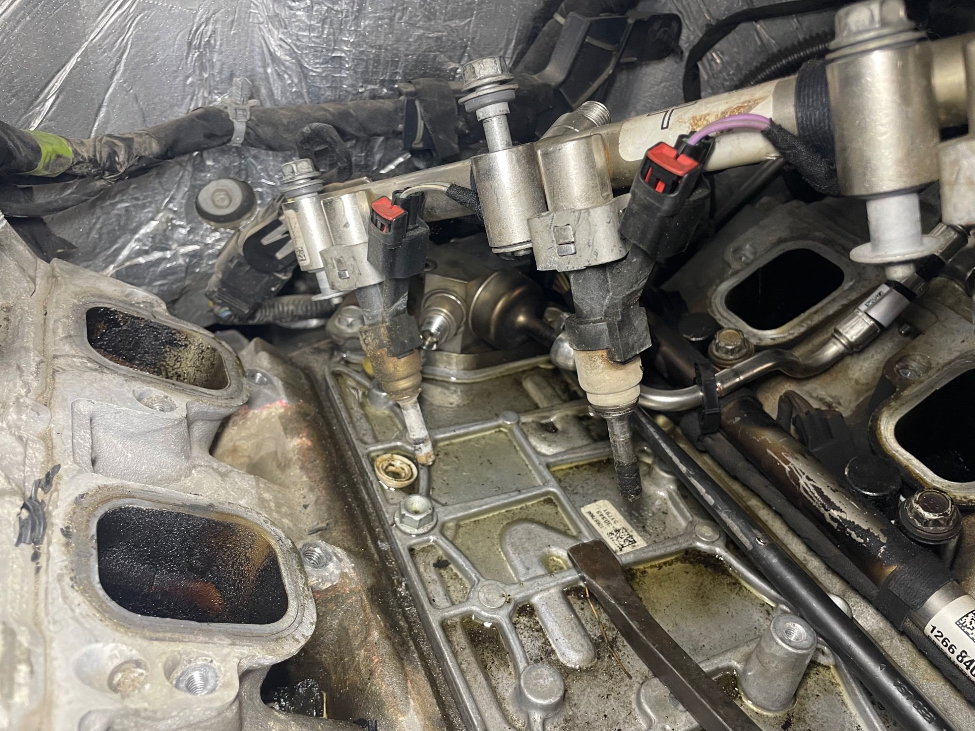

I changed the spark plugs.. didn’t work. I moved coil packs.. the misfire didn’t move. So we watched Live data on the scanner and injector 7 was acting up. So we replaced all the injectors on that side and this truck is still missing.. I’ve ran seafoam through it and cleaned the throttle body and MAS.  My buddy things I have a valve issue or something wrong with the cylinder…

We replaced all injectors on that side. It seemed like injector 8 was working fine but #7 was acting weird on the live data scanner.. so we replaced all 4 just in case. The weird thing is the truck idles like crap but drives amazing.

Okay I’m sorry I have you guys confused. I have a misfire on cylinder 8. So if you’re looking at the front of the truck, it would be the furthest cylinder on the passenger side. We replaced all the injectors on that side of the engine. I’m not sure of the injector # correspondence but we replaced all the injectors on that side and still have a misfire. All the connectors looked good as well.
