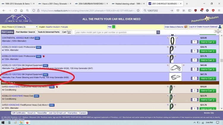

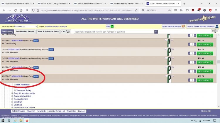

I have a 2001 Chevy Silverado-4.8 liter 4x4-105 amp alternator. I've been using the wrong size serpentine belt
I have a 2001 Chevy Silverado-4.8 liter 4x4-105 amp alternator. I've been using the wrong size serpentine belt.
Let me explain.
I was getting a squealing/chirping sound coming from the belt. I checked all pulleys, bearings etc. All good.
I've been running an AC Delco 130 amp serp. belt instead of the correct 105 amp serp. belt.
This is the part number I've been using- AC Delco K060930HD. GM# 19186305. Length is 93 9/16. All my recent research shows this belt is WRONG for my truck.
My question is: What is the correct belt part number for my truck? More importantly, what is the correct length I need to buy for the drive belt? My alternator is a 105 amp, NOT a 130 amp.
I already purchased the correct AC belt, no way to screw that up as there is one size, there is only one compressor, one tensioner style for AC.
Any help would be greatly appreciated. Thx!
Anthony
