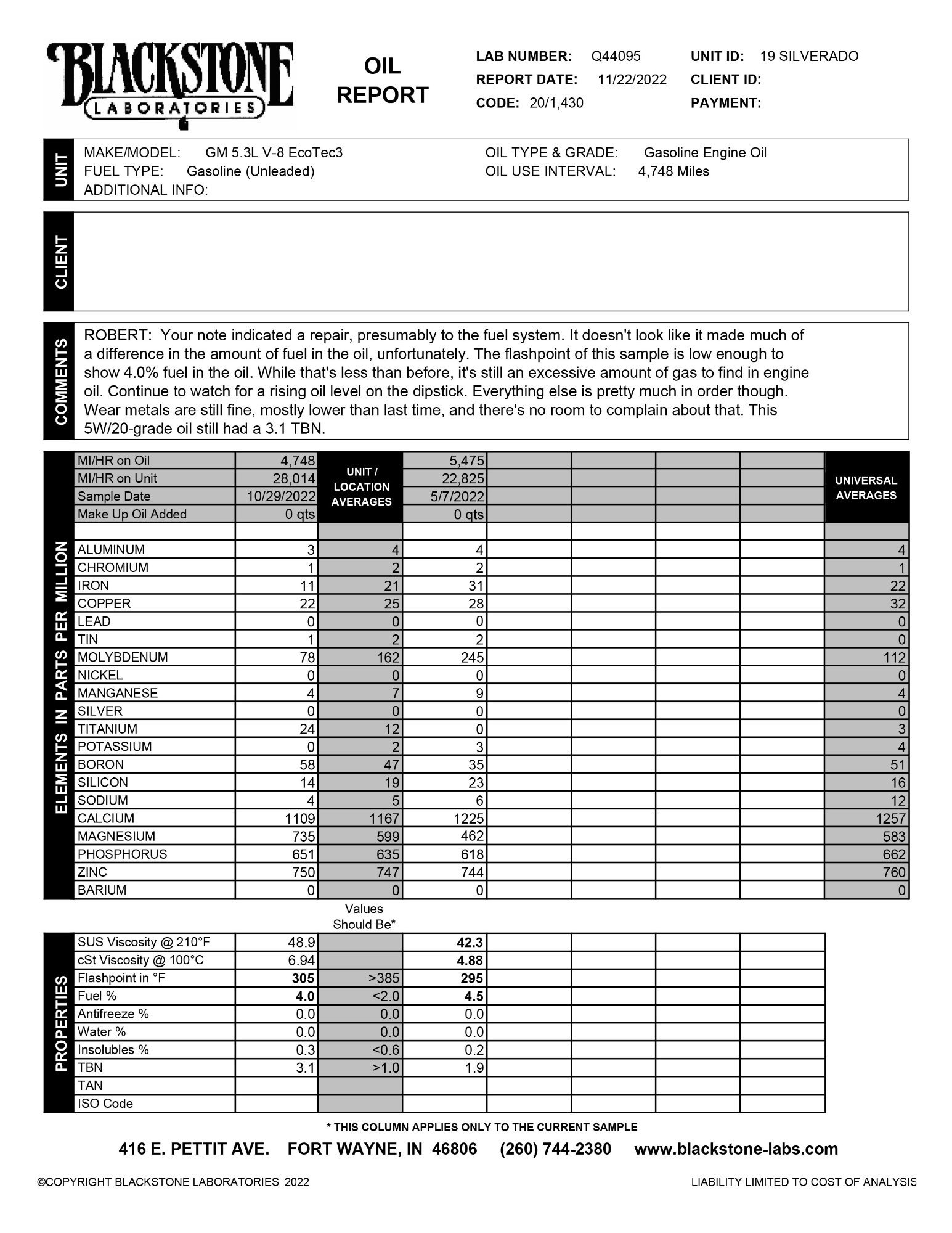

This is an update to a post I made about 6 months ago regarding finding fuel in my oil.  After replacing the high pressure fuel pump, I ran it through the summer and changed oil in October.
This fuel test came back with 4% fuel in the oil.
Dealership is found there are leaking injectors and will be replacing them all as they are not sure which one it is because it is a slight one (fuel pump would always prime when I open the door in the morning),  Parts on order and will get it back at the end of the week.

Well, got it back and it is running SMOOTH for the first time since I got it.  Early on I brought up the slight stumble to the dealer but was told all was ok.  Nope, it was not.
Attached is the used oil analysis that brought the fuel in oil to light.
This test.  Is this pre injector replacement or post injector replacement?
This was pre-high pressure fuel pump around Memorial Day and pre-injector replacement this week.  Will have to get it checked after some miles to see if it really is fixed.
